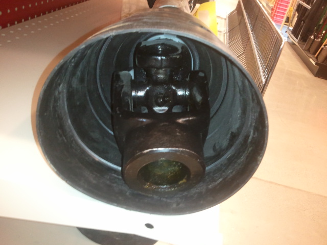

I did get to Big R and they have several complete PTO shafts in stock that would work for you.
Also all the parts to change it over if you need to do that.
I could help you get the right parts if you need to, just let me know.

Thank you Wolfman,
It's very gracious of you to check those and to offer help. That is a beautiful display.
I see the smooth bore yoke with keyway you are holding. Presumably that would replace my yoke and shear clutch leaving me without shear protection. I suppose I could get some sort of shear yoke for the tractor end.
Also I think I need 1-3/16 ID on the yoke with a 1/4" keyway.

That was only one of the multiple ends they had available.
When time comes I'll get you the run down on all the right parts and prices.
You might be able to just reuse your end on a new shaft assembly too.
