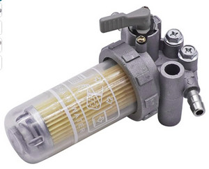

Hi Yet Again,
Wish there was a Sticky for "How Do I take THIS apart Without BREAKING it??"
Just the fuel filter on B7100 etc. You know:
That ring with the bumps on it unscrews, right? CounterClockwise like it should, Right?
Hand/rag doesn't move it. LIGHT grab with Visegrips wiggles it. Only that one bolt holds it in place. REALLY don't want to Break That.
Maybe there is a Tool for That? What do YOU do??
Mine has metal bowl so I can't see the element. Probably it Ain't Broke and Ain't clogged and it can wait until Spring...??

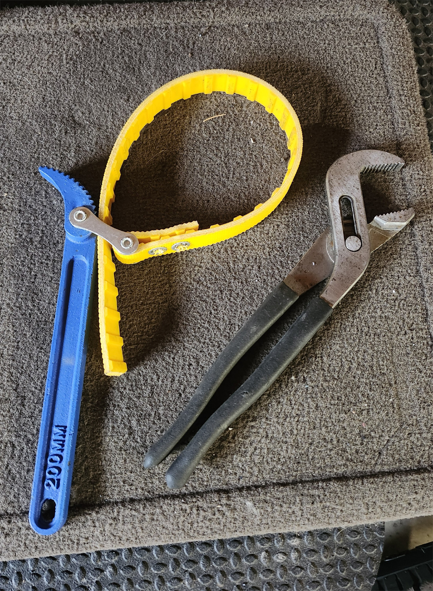

Just like anything round, you want to grip it with as much force as you can all the way around without squeezing it at only two points. Strap wrench or pliers with round jaws.
filter wrench is a good idea. lots of different designs.
I use a large set of channel lock pliers if a rag and hand doesn't do it.

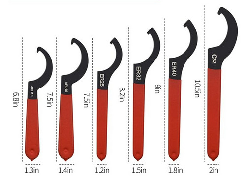

A Coil-Over Spanner-Wrench will also work.

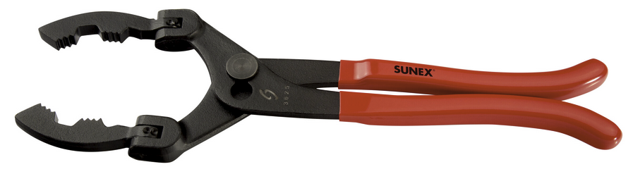

I just use a large channel lock pliers or oil filter pliers similar to what dustball posted.
Do you have a harbor freight near by?
either of these will work (from harbor freight), these are what I use. The red handles doyles are simple to use if you make sure that the tip pushes against one of the raised edges of the filter lock ring.

Spanner wrenches are thin and slip easily, though they do work well on coil-overs.
