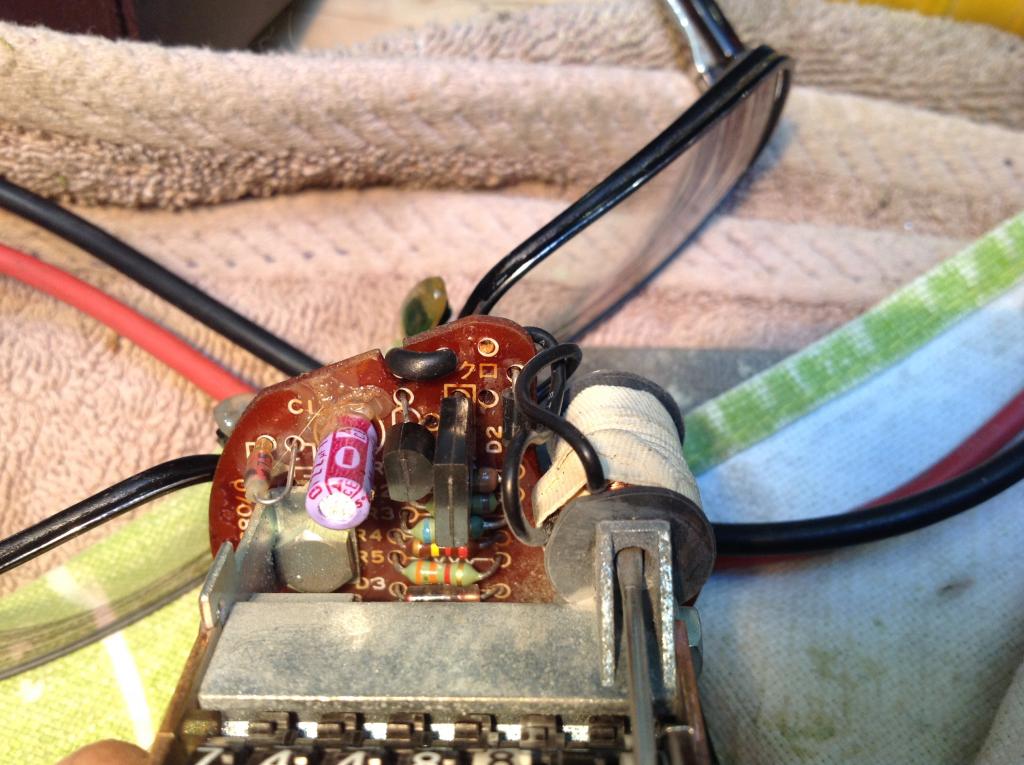

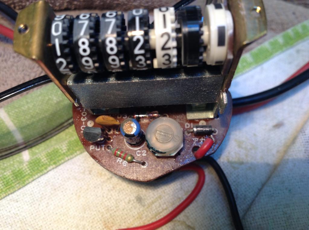

Well, i decided to do it now so after stripping the works from the housing i found that the gears were dirty and not moving so a blow out and brush up freed all up and the counters shift as they are designed to do.
However.... Power is not reaching where ever it is meant to reach ...i presume this as the little arm that sits in the small coil does not raise up and down thus turning the first wheel....and as the 12v routes through a circuit board i am now stumped as i do not have the knowledge to check all the little bits that are attached to that circuit board!
I am a quick learner if some one can point me in the right direction though.

Carl, that's an interesting and different clock mechanism. Evidently that circuit board is a timing circuit that sends an electrical pulse to that coil every 6 minutes......1/10 of an hour to jog that lever and the 1/10 hour wheel. If you could somehow find a schematic for that timing circuit through the manufacturer we could help you trouble shoot the components. I'm not an electronics expert but it can't be that complicated. Can you post a pic of any tags or model numbers on the device? Even some close up pics of the individual components might shed a clue as to what kind of a timing circuit they're using. There's got to be some electronic gurus on OTT that can help, too.

The easy way out would be to purchase a new replacement meter.
But if you are keen on repairing then the first step is to learn soldering and desoldering, electronics style. An amateur radio operator or a local vocational school could have you doing that in short order.
Checking the arm in the solenoid which moves the counters, does it move freely or is it frozen?
There are 2 blue cans labeled C1 and C2. These are electrolytic capacitors which should have reached the end of life. They are polarized so plus must be to plus and minus to minus.
Looks to be some plastic cased transistors. These also would be first suspects. There should be numbers on these devices by which the replacement devices may be chosen.

I am no electronics whiz, I know just enough to know I am clueless. But....
Most common fail point is salts on the circuit board. Next most common next is the capacitors. lastly is the solenoid. Very, very rare is it a IC.
I see rust on your board. Which means water infiltration.
The cheapest fix is cleaning the board.
Getting unpurified water (rain or drips from weed spraying) on to it, the water drys, leaving behind minerals and salts. These can 'short' the board and prevent timing signals (very low power) from making the transistor (which is a switch) operate. So you need to literally wash the board.
Take some distilled water and a clean tooth brush. Dip the toothbrush in the water and simply scrub (gently) both sides of the board. Do not be afraid of getting things wet. Do be careful not to scrub too hard. You just want to get any deposits on the board into suspension in the water. Dip the brush in the water alot, let the excess water on the board drip off. When you think it is as clean as it will get, use some low pressure air (canned air is gentle) and blow dry. Let sit in the sun (like on a window sill) for a few days.
Next, use a Q-Ip and some Isopropyl Alcohol and gently rub the board. It'll dry quick.
Lightly lube the clockwork. Ensure the plunger in the solenoid moves freely and power it up.
If the cleaning fails, next I'd change out the capacitors. Same ones or higher voltage is what you want. You do want the rating (uf) to be the same or very close. Watch polarity.

The plunger and gears all move well and correctly so i will look elsewhere for the fault and as suggested start with cleaning the board. I will look to follow your steps from there.
I agree i could easily keep the cheapo chinese counter i have in there but this may not last and i admit to wanting to repair this one. I tend to repair any thing here if i possibly can so even if this is a slow job i will work my way through it. Besides i still enjoy learning new skills and gaining knowledge and electronics are new to me when it comes to circuit boards so thank you once more.

I suggest getting a small soldering iron, small diameter electronic solder (no acid, not plumbing), small braid for de-soldering, needle-nose pliers.
Find an old circuit board to practice soldering and removing components. Just the right amount of heat, too much and the trace conductor will lift off of the board. Not enough heat, and you will have a cold joint which is not conductive.
Keep good photos of your meter board as you go. Some of the components such as transistors may be out of date but proper replacements can be found.
The circuit is fairly simple: a timer and a driver for the solenoid. The components to be replaced are inexpensive. When you are ready to identify components, post your pictures and numbers or colors or other ID marks to get suggested replacements.
