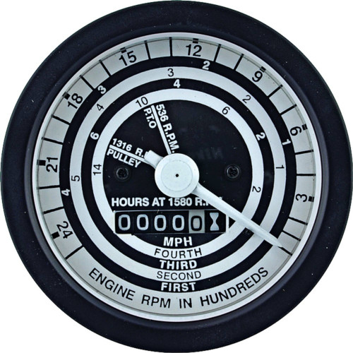

I had noticed before, but recently I really took a look at the hour meter during operation compared to actual clock time. I have been running my tractor at about 1700 rpm for several hours and compared the recorded hour meter readings to the actual clock time. 1700 rpm is about 60% of 2900 full rpm. Then I looked at the recorded hour meter time and it was about 60% of the actual clock time. Has anyone else noticed this?

If your tack/hour meter has a drive cable, what it is actually measuring is the total crank revolutions, just like the odometer on your car. The manufacture then just takes a guess at what the average rpms will be, does some math to find the # of revolutions in a hour, and uses that as one hour of usage. Some of the old tack/hr meters would state, hrs at xxxx rpm.

I have a tractor with a cable driven our meter and another with an electrically driven meter. The electric one is just like a clock. It increases one hour when my watch increases one hour.
The cable driven hour meter is designed to change one hour for each hour the engine runs at PTO speed generally, but it could be defined as any speed. So if PTO speed on my tractor is 2500 RPM to get 540 out of the PTO, then if I run the tractor at 2500 RPM for one hour, the hour meter will increment one hour. But if I run the tractor for one hour at 1250 RPM, then it will take two hours on my watch before one hour increments on the cable driven our meter.

Yes. That is what I was trying to get at.
