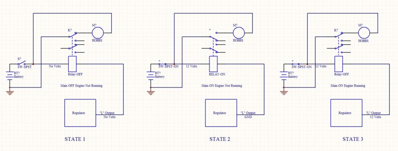

It can probably be repaired by an independent instrument repair company at some expense greater than just replacing it with a generic meter like a Hobbs hour meter. Zoro has the round meter for approximately $26 and the rectangular for $23. Below are the wiring instructions. Just don't forget to turn off the key, or it will be racking up a lot of hours. You can Google Hobbs hour meter installation instructions if you need more help. Same for locating the meter itself.

If it is a cable driven meter, just put an electric one in it. They are cheap and reliable. You can even fit one that only counts when the engine is running. Not just key on.
