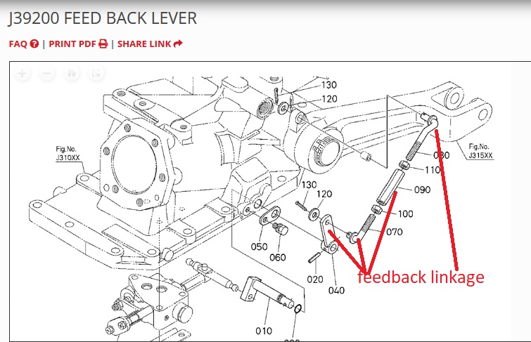

Could something be causing a relief valve to be constantly discharging oil which will raise temps.
Example, a 3 pt hitch where the feedback rod is not adjusted properly.
When the 3 pt arms reach the top of their movement, the valve sending fluid to the 3 pt lift cylinder should kick off thus putting the hydraulic system back to low pressure.
This image is for a M5660 just to give you an idea of what the hardware looks like.

Thanks, I will look at that and see what I can find.
