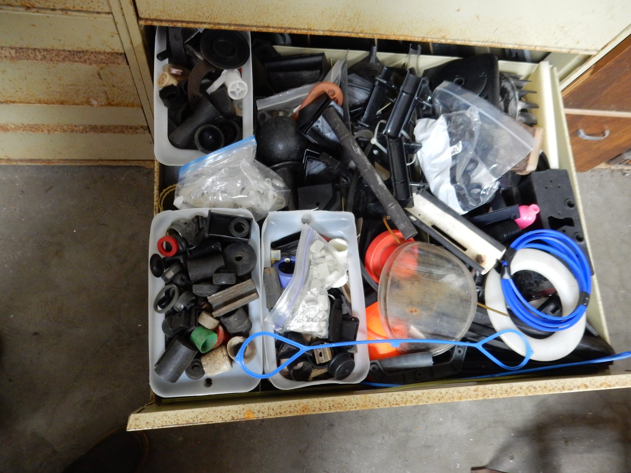

My factory male caps come off as well. I am using the cheap plastic blue pipe caps that come on pipe or fittings as a protector. Just happen to have a box of various sizes and types that I never threw away. I even save the plastic caps that come on battery posts. You never know if you will find a use for them some day. Maybe this is the reason why I have so much "stuff"
6,650
4,203
"Pack rat" ??
Me too !!!
