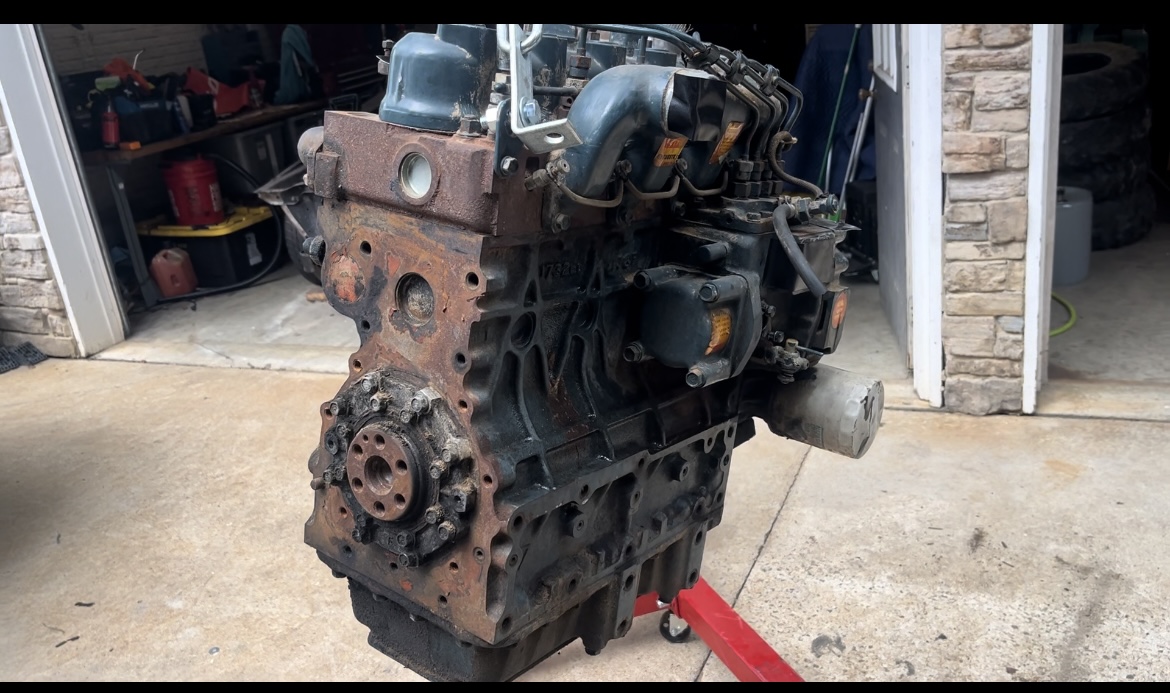

Hey folks, New to the forum. I figured my latest project might be of some interest to yall. I recently bought an old V1702 4cyl diesel off of a buddy of mine. It was originally in a bobcat skid loader. It was missing some parts and needed some attention. Hasnt been run in years. I got a flywheel, bell housing, throttle plate, shutoff plate, lift pump, and solenoid. It runs like a champ now. I welded an engine stand with some 1-inch steel tubing. I had an idea after seeing the aftermath of Hurricane Helene and decided to make a generator. I did some rithmetic and research and decided that 15kw should be plenty to run all my home appliances. I have been working on getting some engine accessories like switches, gauges, sensors, etc. My goal is to have a robust, self regulating generator on a budget. I am working on finding a generator head and a governer to regulate the engine speed and therefore regulate the AC frequency. If I opt out of that then the loaded frequency will be lower than it would be unloaded. Any advise or critiques are welcomed.

But where’s the fun in that 😀. I did look into this and apparently the v1702 was a less powerful engine than the v2203. And most people just drop the 2203 in place of the v1702. It would not be worth it for me to sell it and try to find a good 15kw generator

engine is 35-40HP, so should power the genny fine.

15kW is just about 20hp at 100% efficient conversion. So factor in mechanical and electrical losses and you need maybe 25hp output from the engine?
You need 2HP per a KW to be able to get the max output from the generator.

Most/many generators rated at 15 kW or so are designed to run at 3600 RPM for 60 cycles because the engines they are usually run with put out near max HP at that RPM.
I expect your 4CYL diesel does not run that high an RPM?? What are its specs?? I THINK that many/some of PTO driven generators have gear-up or Belt-up attachments or are designed to run at lower RPMS. One way or another you need some MatchMaking here. Or you may end up with 30 cycle AC..

Generators can be either a 2 pole design or a 4 pole design (there are other pole speeds just like electric motors). If the rotor of the 2 pole design is turned at 3600 RPM (plus the slip) you get 60 Hz out of the stator leads. If the rotor of the 4 pole design is turned at 1800 RPM (plus the slip) you get 60 Hz out of the stator leads.
I assume you are questioning if an engine that cannot get above (say) 1900 RPM can generate 60 Hz power and the answer is yes, if connected to the correct generator. If I misunderstood your asking, I apologize for the needless post.

from what i have seen, that engine is good for 40hp. a 15kw generator at that speed will only eat up about 30hp.
