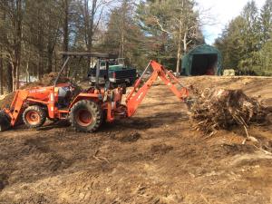

That stump is about the size of the tractor portion of my TLB, took about 5 hours some by hand, most with tractor and a final yank with my pickup and a recovery strap. Finding and cutting the tap roots of the 30" Doug fir was the big challenge.
