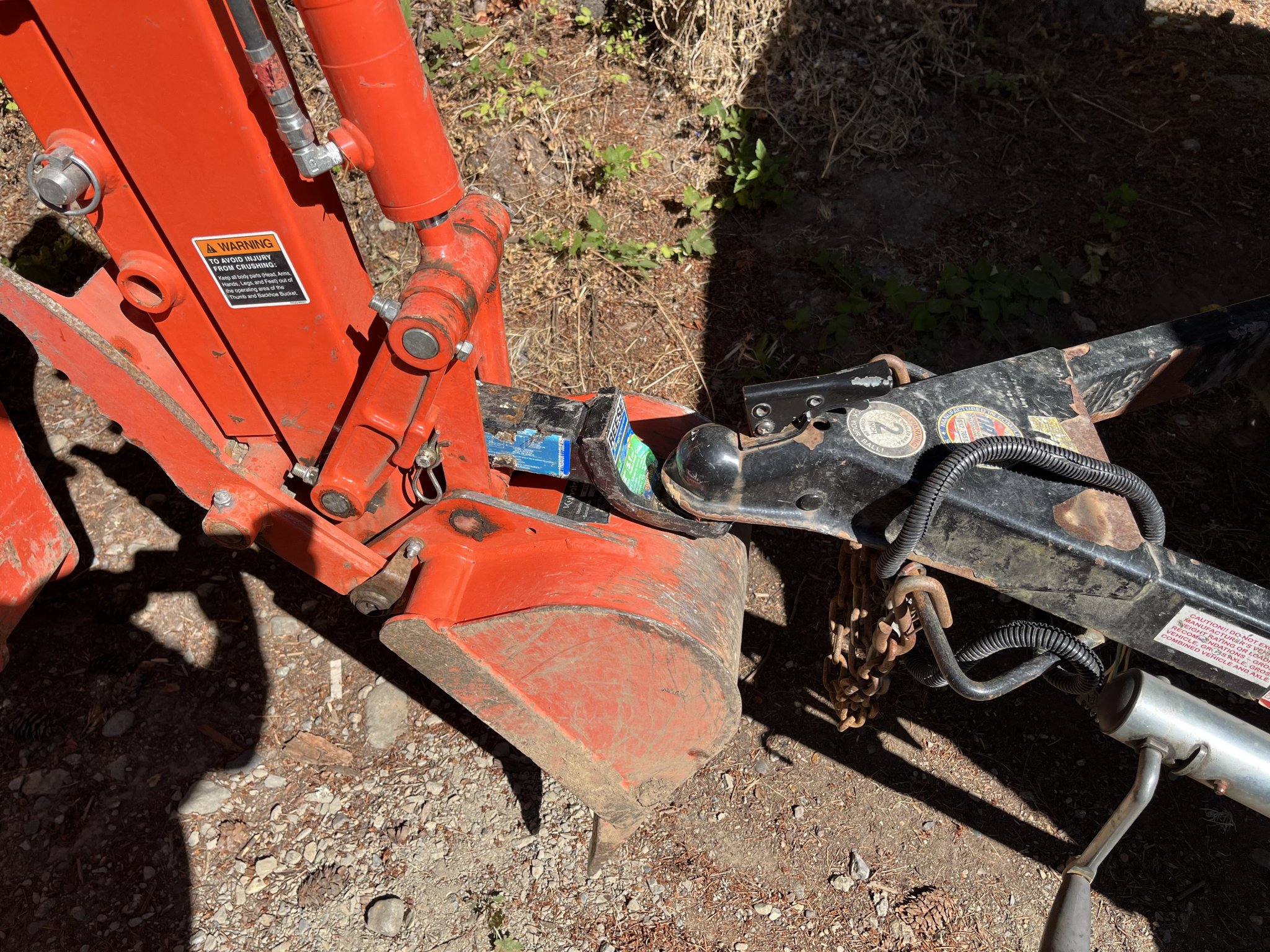

Lot of guys drill a hole and install a ball into their bucket, as they can still fully use the bucket but also easily get under a trailer and move it without even leaving their seat, and backing a trailer in is easier.
