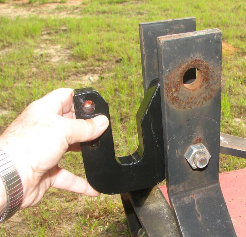

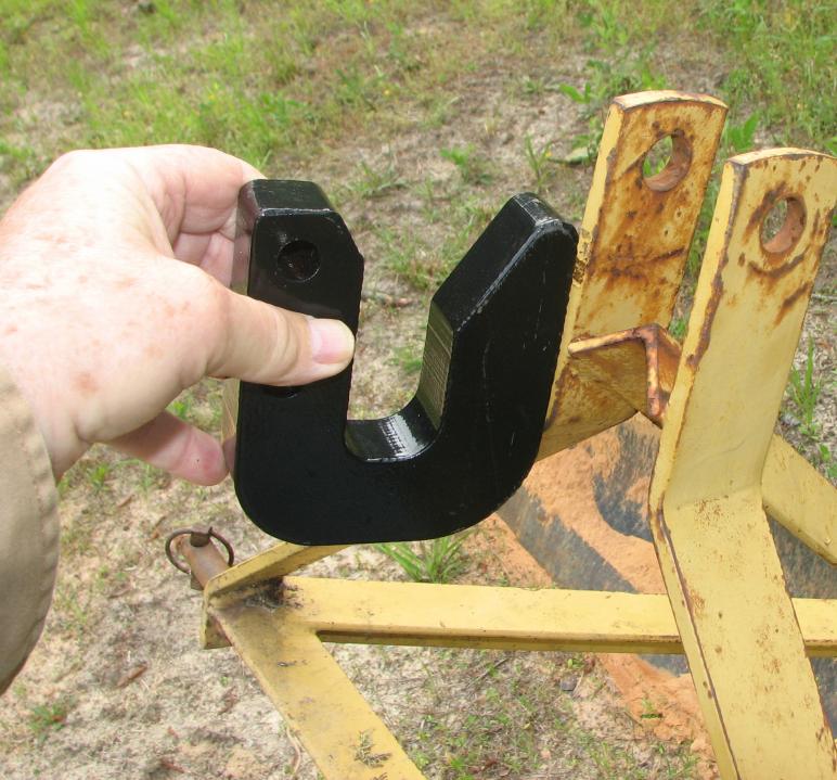

bought a HF quick hitch and nothing fits?
I ordered the adapter, maybe then it will work but I guess it won't be a "quick hitch" then.
the pics show why it won't work.
I also have several other implements that don't fit, yet, maybe after I get the adapter?
I guess many others have dealt with this but I wanted to show others that haven't bought one yet what to look for and what to expect on their equipment.

Your three implements shown are out of specs for quick hitch. The top pin should be very close to 15 inches above the lower pins, and accessible from below by the hook. The non-quick standard height is 18, so that's why most quick hitch hooks adjust. But it still needs bottom access.
To use the hitch:
1.The adapter will usually work with them
2. You can often hook up the bottom (if in specs), then insert the loose top hook upside down over the implement pin and then pin it to the quick hitch.
3. Modify the implements.

jpf,, this is a common complait. There is not an industry standard for the exact spaceing for the hookups within the catagory 1, 2, and 3 implements. There are specs for the size of the pins and a general width of the lower arms, but that's it. The quick hitch I bought only easily fit one of my implements, the rest I had to modify. Once you get that done, life on the farm gets a lot easier.

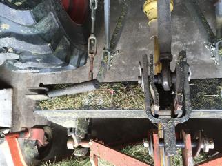

Ike, here is how I hook up my mower so that I don't have to wrestle with the pto shaft at the tractor" very tight work space'". See pic. Basically I hook the tractor side first then hang the shaft off of the quick hitch using baling wire or what not. Once I have it hooked up, then I attach the shaft to the mower. Works like a charm.
When I first came here I didn't know the difference between the categories. Still cant tell you the exact measurements. One problem I had, my box blade was a cat 2 with cat 1 sized pins, this really confused me. All other implements I have are cat1 so they hook up nicely with the quick hitch. Yes I still have to get off and adjust the top link so the "y" fits into place but it sure beats trying to adjust the lower arms, there just isn't enough space for me to work comfortably. I'll attach a pic of how my quick hitch lines up with my cat2 box blade. As you'll see it doesn't work. I have to take the qh off to use it. Been looking to trade it for a cat2, just haven't found the right one.
