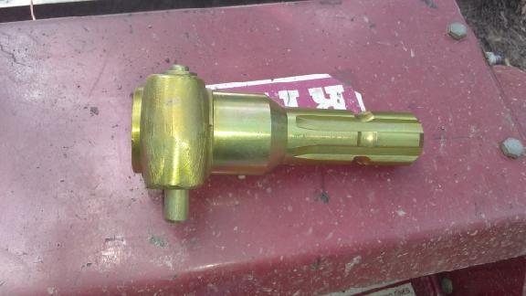

D2Cat,
I ordered a PTO extension last week and it came today. I couldn't use one like in the link you supplied, my PTO shaft on the tractor doesn't have a hole in it. A lot cheaper than ordering a new PTO shaft. This is what I ordered:
SidecarFlip
Banned
7,182
562
D2Cat,
Myself, I prefer the clamp on over the pin style. I've has some incidents where the pin style comes off. The clamp on ones never come off but are a but more expensive to buy.
