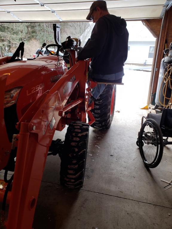

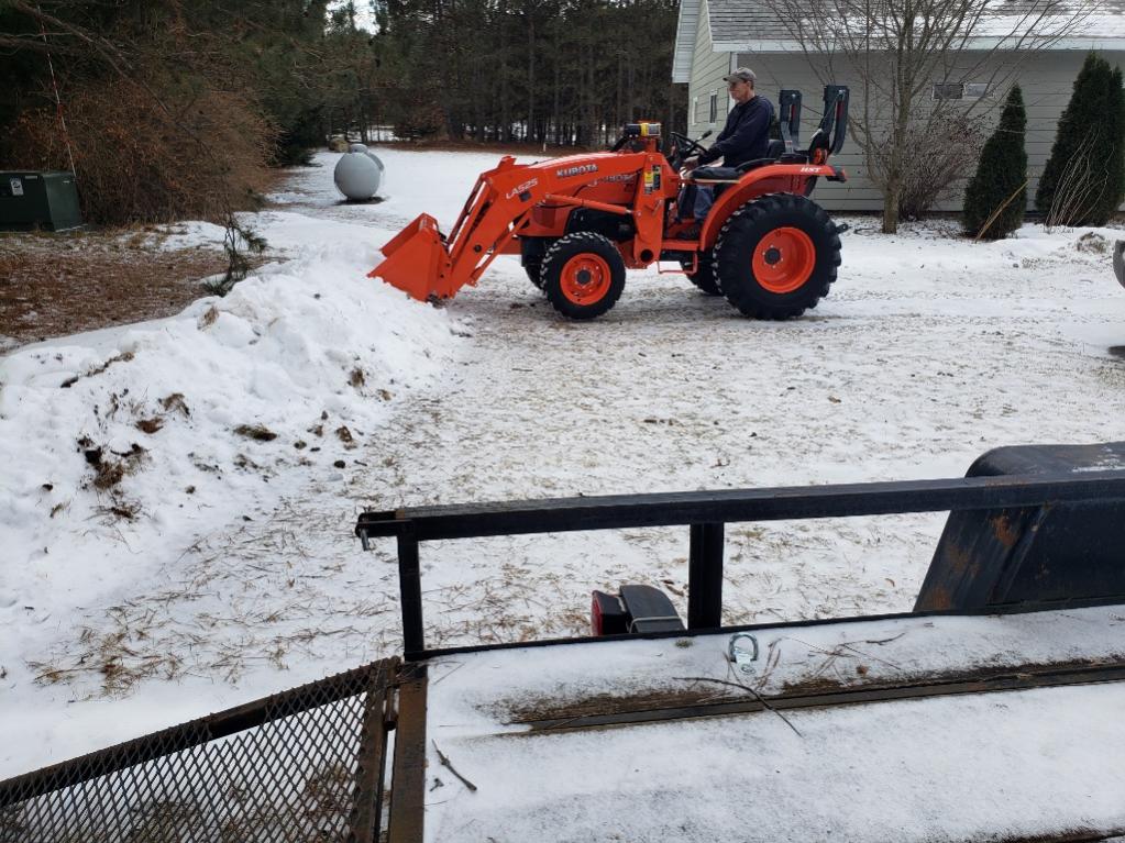

Update on my seat lift. I was able to get out to the shop and work on my seat lift and today was able to mount and dismount the tractor without issues.
I now have the seat size worked out and will build a seat with a 1/8 inch metal pan with small back rest and side hand holds. I am also running a lap belt for safety concerns.
Along with that I will tidy up my wiring for the winch and then build a heavy gauge metal "box" cover for the winch to keep it safe from branches, rain, snow. I also intend to install a grab handle on the box. Getting off and on told me where I will benefit having additional grab handles.
