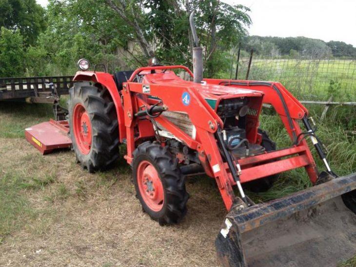

Here is a pic of mine. It's missing the grill right now. If you come across any good info let me know, it's sometimes hard to come by.. Thanks
See that's the problem with a Grey/gray market tractor they are just upside down! :D
Here lets make this right!
olthumpa
L275
May 25, 2011
1,501
38
Maine
Now you have gone and don it!:mad:
That tractor was meant to run on the other side of the earth, thus upside down.:rolleyes:
This tractor is going to constantly get stuck all the time as it tries to get back to its designed orientation on the opposite side of the earth.:eek::D
34,342
9,578
Awww Fudge Sickles! :eek:
I done made a boo boo! :eek:
