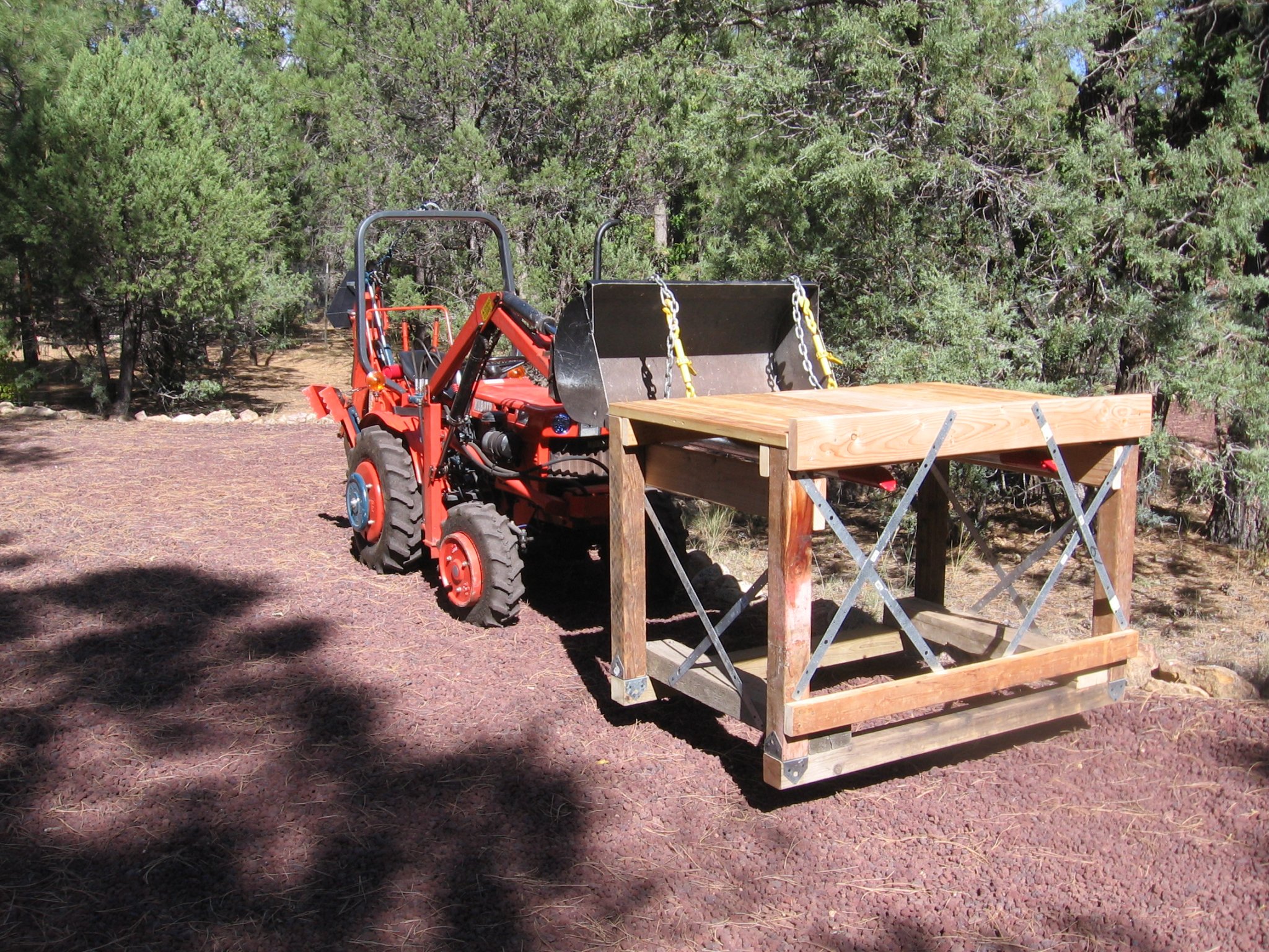

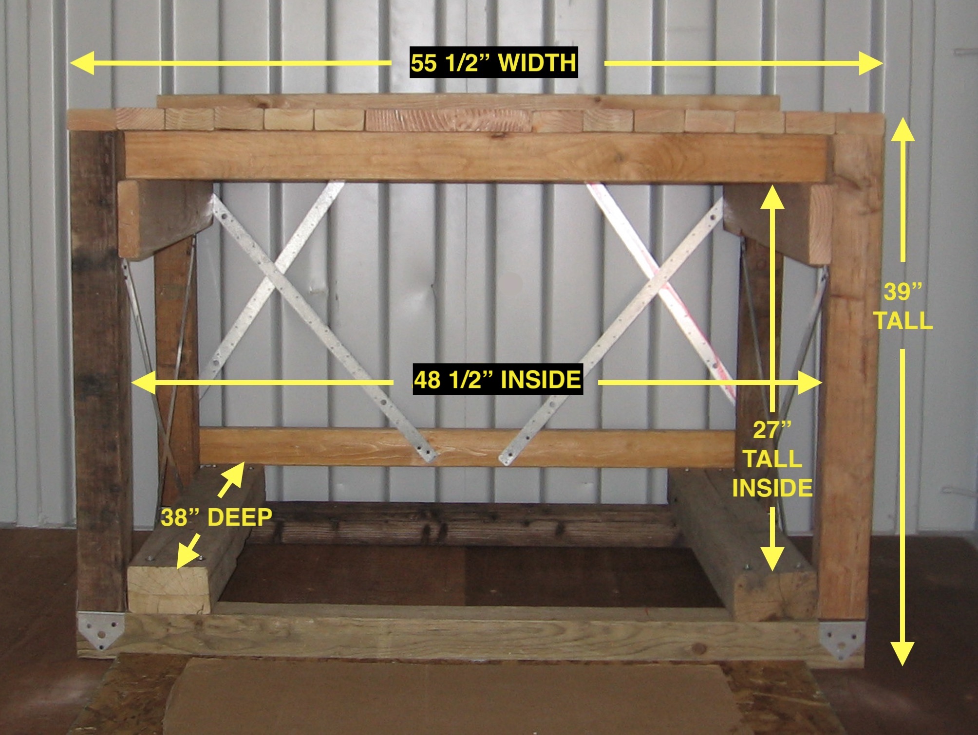

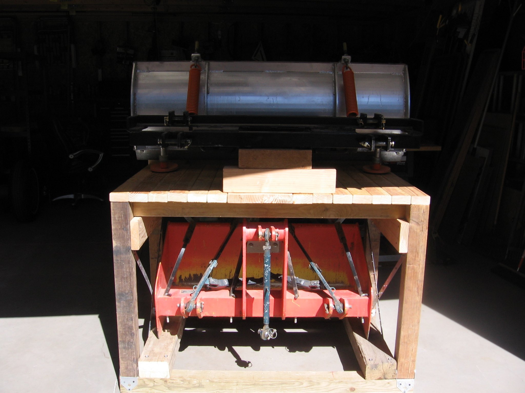

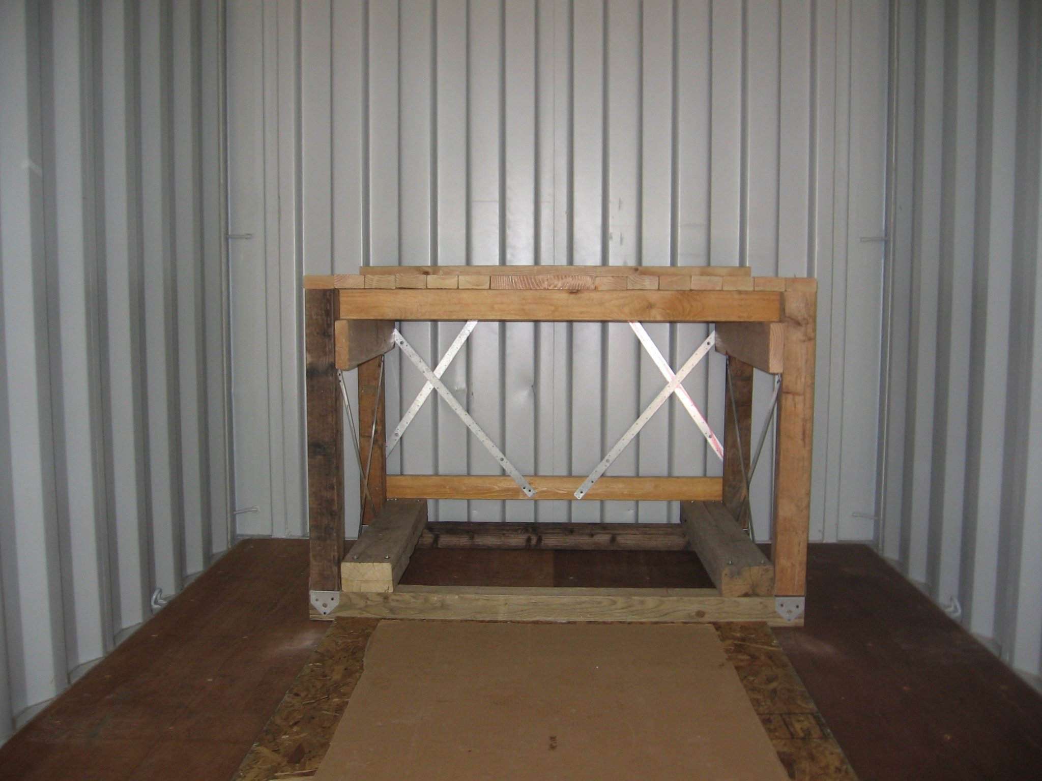

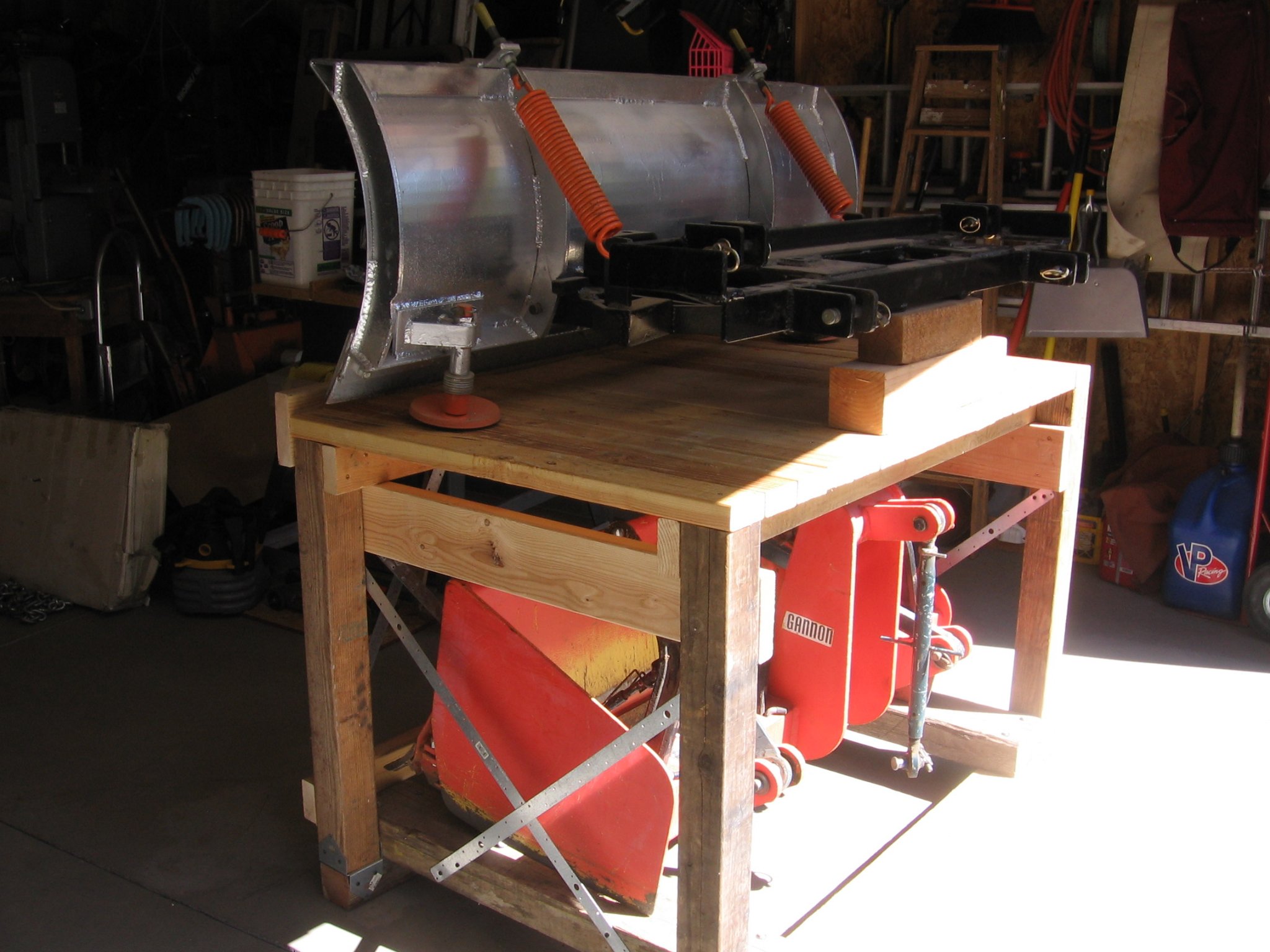

7,965
3,266
I can get dimensions from the rack I built next time I go there, just not sure when that might be.
(caregiver thing)
I remember the footprint is 60" x 39"

David as a reference, that rack is 43" from the bottom of the 2x6 to the floor, the shelf is 39" deep as my forks are only 33" long. Only 14' wide.
