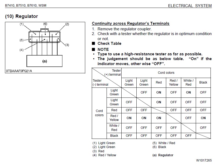

The dynamo rarely fails so I suggest you focus on the rectifier first. The test table is a series of checks made reading resistance or Ohms.
Any test not meeting the table conditions means the regulator has failed.

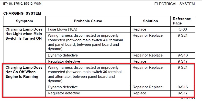

From the WSM, the trouble shooting suggestions for the condition warning light always ON.

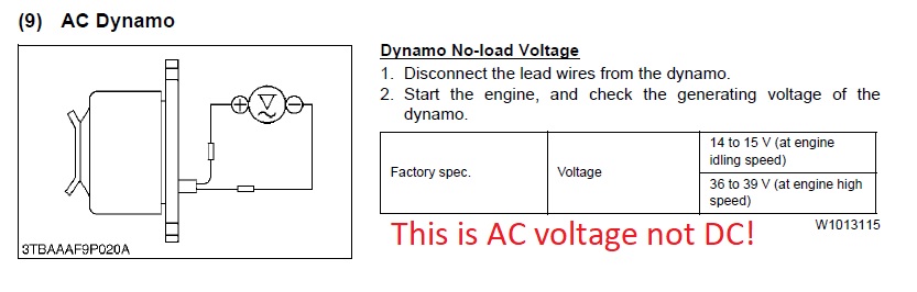

Remember that testing the dynamo involves measuring Alternating Current voltage not the usual Direct Current voltage.
Dave
