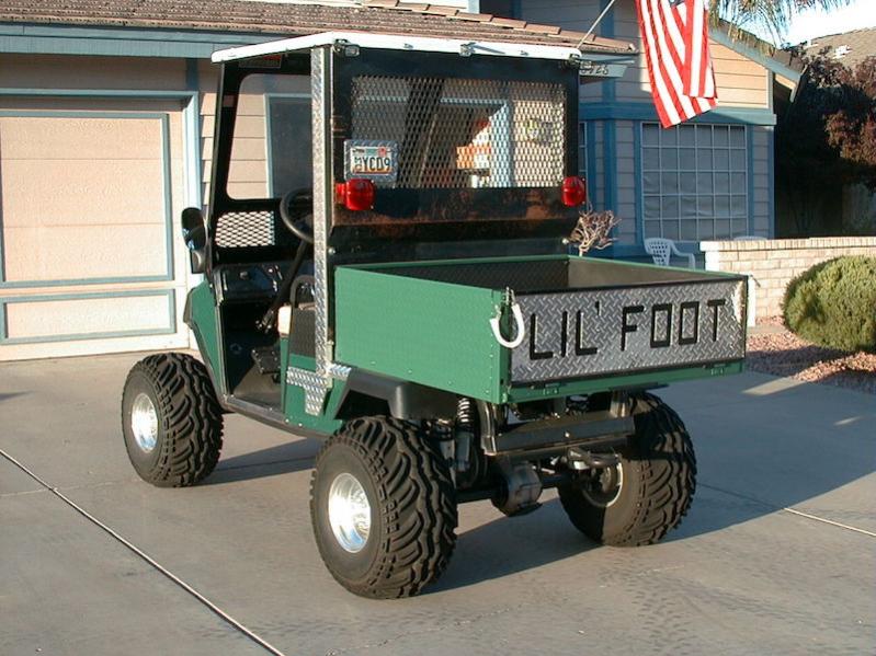

Years ago when I first built Lil Foot, (1st pic) I went to the dunes (Buttercup) for some testing. Somehow I used a crappy grade 3/8-16 bolt instead of a Grade 8, and it sheared off. (2nd pic) I tried everything I could to get it out, but had no luck & was about to head home, when someone said I should go talk to a guy with a semi rig camped nearby. He had converted his semi trailer to a combo toy hauler/machine shop, and slept in the sleeper. He had a huge selection of tools, (4 rollaways, if I remember) a full size drill press, Bridgeport mill, 10x24 Atlas lathe, hydraulic press, and assorted other tools. We talked awhile, and he graciously allowed me to use the mill & assorted tooling to remove my sheared bolt. He then had a kids wagon FULL of assorted bolts, nuts, washers, etc. where I found a replacement bolt. He would not take any payment- but said to put some beer money in the tip jar on my way out. I had $80 on me, so it went in the tip jar. (after all, he had saved my trip)
My point in all this is that he had minimal lighting in the trailer- a few translucent skylights & a couple of 60w bulbs. As I get older, I find I need more & more light to see well, so I would plan for KILLER lighting inside for those times you must work inside, or maybe just search for a tool.
