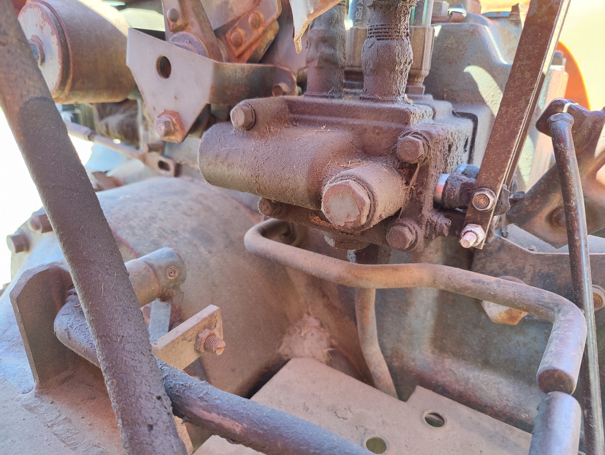

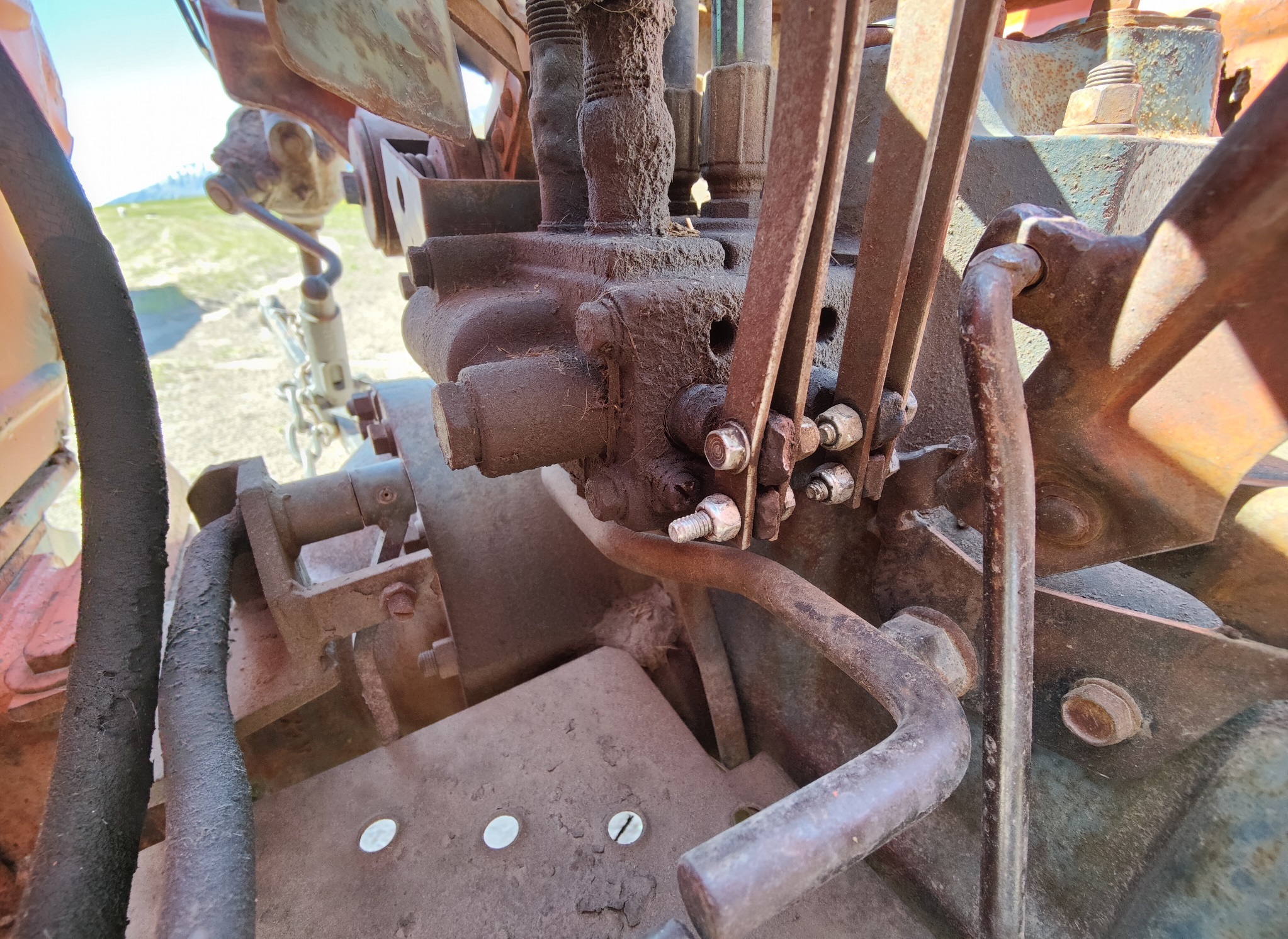

I have an M7500DT with a FEL. I am not 100% sure if the FEL itself if OE, but the valves appear to be. I have a couple goals here, one is to find the correct control handles if they are not unreasonably expensive, and two is to add a 3rd valve to the stack if possible. Also, it would be beneficial if I can figure out what diameter/unit of measurement the fittings are, and what type of connection (I am guessing NTP or the 37* flare fittings I have seen mentioned a lot for hydraulics. I was figuring if I can add a 3rd valve I could plumb it to the end of the FEL for something like a grapple and to the rear to raise/lover implements like a plow/swather/etc. Thank you for your help!

The work port threads are likely M18x1.5 because the valves look very similar to mine. The pressure connection under the valve (line from pump to valve) is probably 1/2" BSPP, don't ask me why they have a mix of threads on the same valve....
The rest of the fittings could be anything. The only caution I'd say is not to use NPT if you can avoid it.
Much like you, I started out wanting to add another valve to the stack. I couldn't find enough information to be certain that I could stack another valve so instead I added a 3 spool valve (joystick plus spare spool... you never know when you might need it...) which has worked brilliantly. And guess what... I am now using all spools except one.
I hope you make everything surgically clean in the area before you start unscrewing things :)
