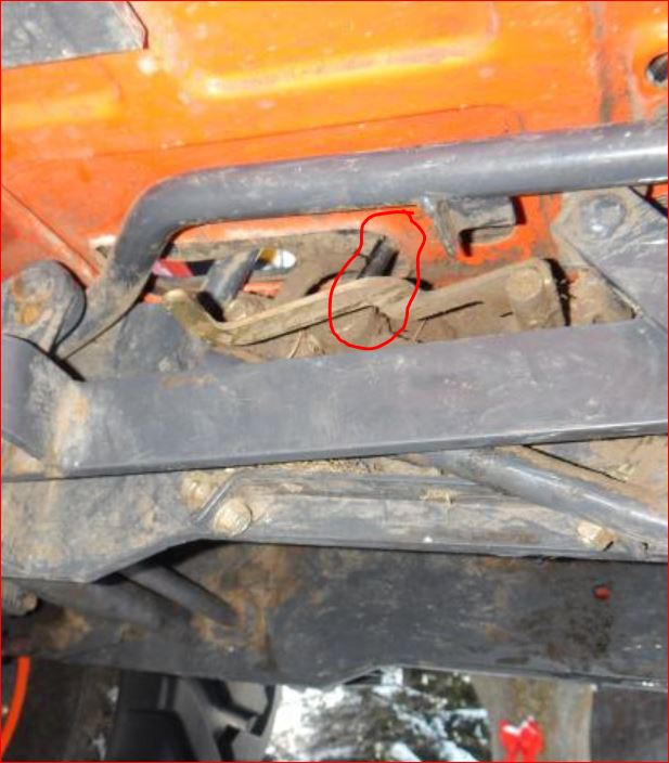

Thanks guys, sorry no pics earlier. well I walked around and found a piece of what looks like brass or something but it is a rod with bent ends, it is in the pictures, have a feeling its part of the issue but still a mystery. any ideas from the pics let me know. Ty

Would that cause the forward/reverse pedal to disconnect? I am so lost with this, I literally need this explained in detail, I am used to cars, lost on tractors.

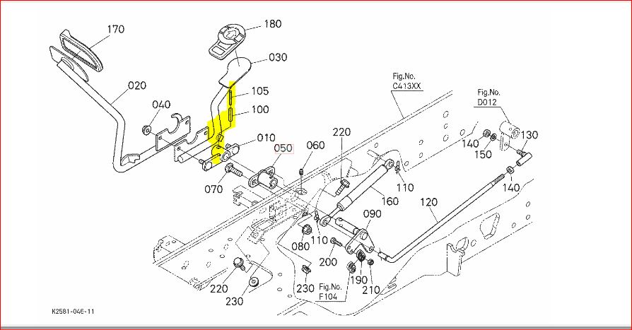

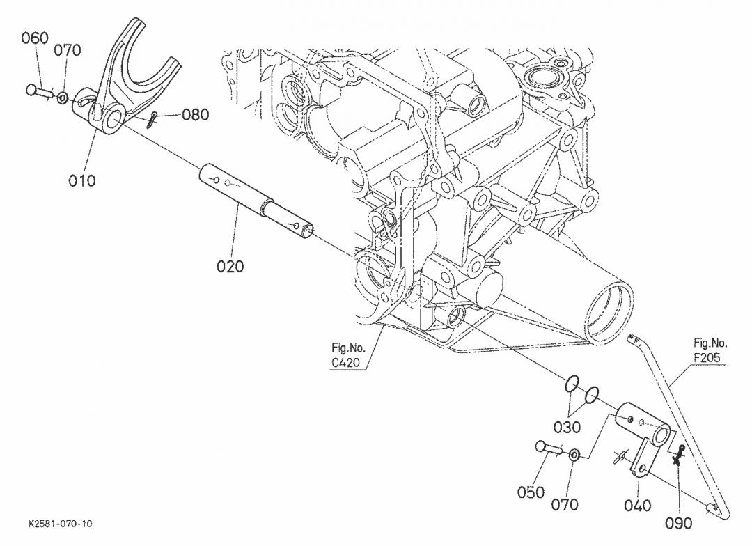

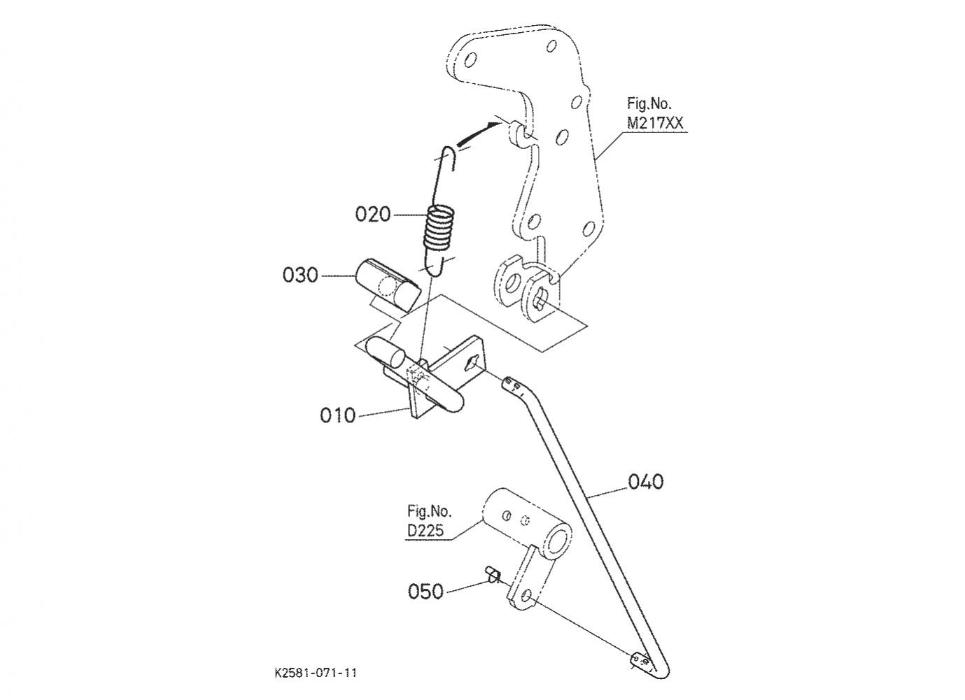

To find what is loose, have some one move the pedal up and down. You should be able to see some hole that the linkage you found (bar bent at both ends) will fit into. Put one end into that hole, then move the link around until you can find another hole that the linkage will fit into. You may need to hold the pedal up into what is its normal position (if you can recall where that is). See if any of these looks like the diagrams that Profnohair posted. Try to make it look like the diagrams. Then gently push the pedal and see if it seems to move correctly. If it does then start the tractor and see if it moves. If it does then you can get the proper clips from the dealer and any other missing parts on the linkage and install it properly.

This is just a wild ass guess and I could be wrong, but it looks like in the photos that the roll pin that attaches the pedals to the shaft has backed out.
You get to the pin by pulling up the rubber mat and the pin will be accessible just in front of the reverse pedal.
You can confirm this is the problem; while under the tractor move the pedal and if the shaft doesn't move it's the pin backed out, if you notice in the print it is actually one pin inside another.

You might get lucky and find the clip you need at a local auto parts. Worst case, use a thin washer (if there's enough clearance) with a cotter pin to get it going while you order the proper clip from the dealer (if they don't have it in stock).
You can also order the correct clip from www.messicks.com if that's easier for you.
