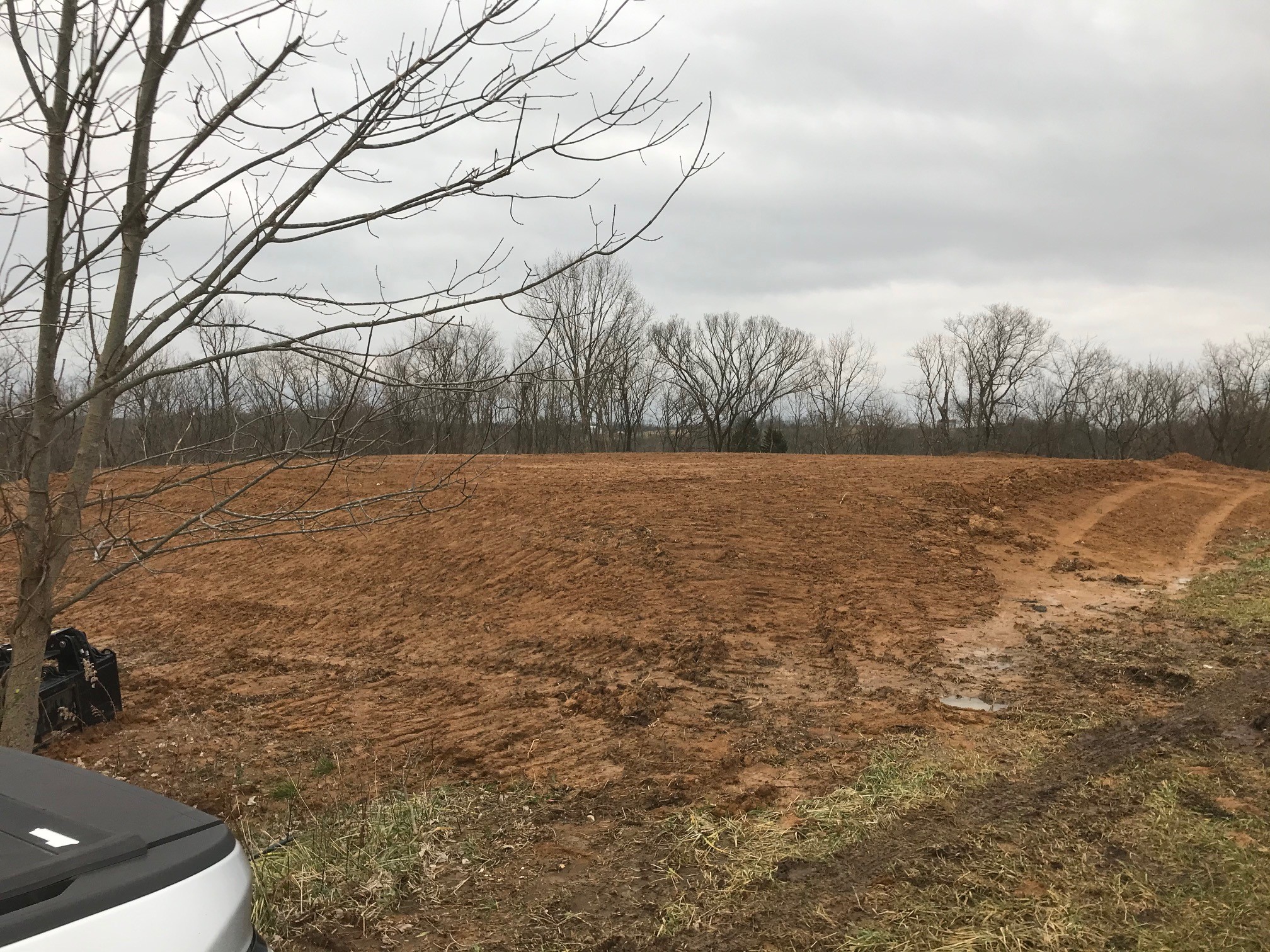

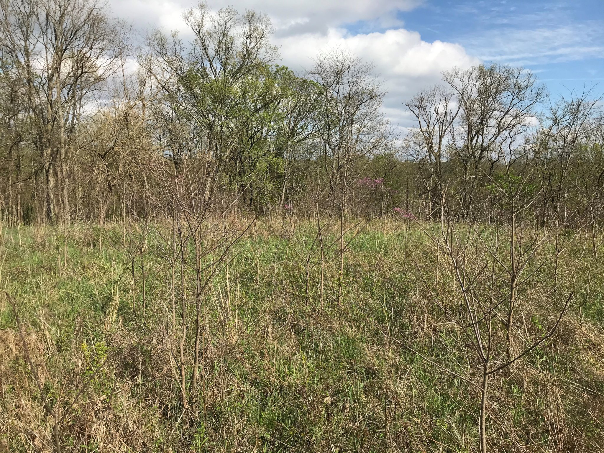

We're in a similar situation except this isn't our primary residence but rather a weekend place so getting it done quickly was less important than saving some money. We have 44 acres with a building site right off the road.
This is what our building site looked like when we bought the land. It's about a half acre before you get into the thick woods in background of the picture. I started clearing this myself by hand with a chainsaw and weed eater with brush cutter blade when a neighbor who had a land management business stopped by and suggested he could help. He cleared this plus a bit more into the woods with a tracked skid steer with mulcher on the front for $500 in a couple hours.

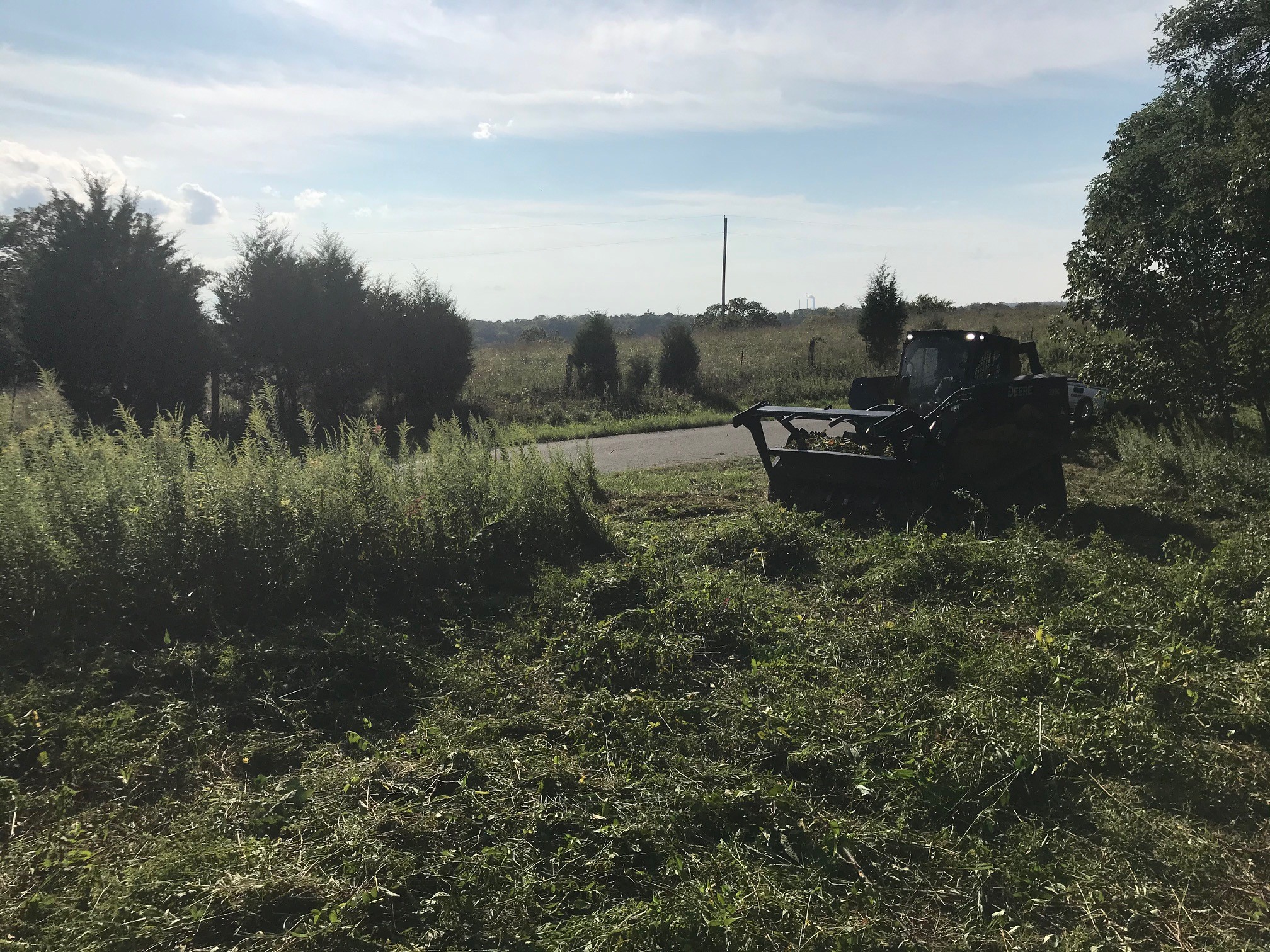

A few months later I hired him to clear into the woods 50 yards in each direction to give me 2+ acres to build on. He charged $5000 and was there for a week or two with his mulching skid steer, bulldozer and another piece of equipment which turned a 40' tall tree into a pile of mulch in less than a minute and when he was done it looked like this. Best $5000 I've spent.

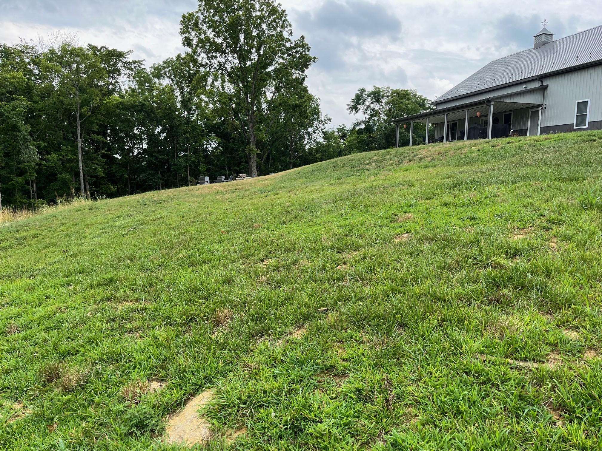

This was all a few years ago. Now we have our building up and I have worked my way into the woods, with my chainsaw mostly, but also with the tractor and rotary cutter so things look like this now. The section off to the right in the second picture is what I did with the chainsaw and tractor and it goes in about 50 yards deep and about 20 yards wide.
As you can see our building is up on a hill and overlooks a part of our woods. We want to selectively clear part of woods to have views down into the valley to a stream. I'll venture further into the woods this winter now that our building is almost done. It'll be a lot of manual labor with the chain saw, and weed eater with the brush cutter blade clearing brush and trees up to 4-5" in diameter to get some of the views we want. I have a Woodmaxx chipper on my tractor which works great, but we'll also do several burn piles to get rid of everything. I've got lots of time to work on this over the next several years.
My lessons learned are: 1) While my tractor and implements, UTV, chainsaw and weed eater with brush cutter blade are extremely useful tools, the work is hard and time consuming. 2) Money spent on professional land management services is money well spent. It would have taken me a year or more to get done what the land management company got done in less than 2 weeks with their equipment. Given enough time a lot can be accomplished with a smaller tractor (I have an L3560 ROPs) with front end loader and implements, a chainsaw and other tools.
