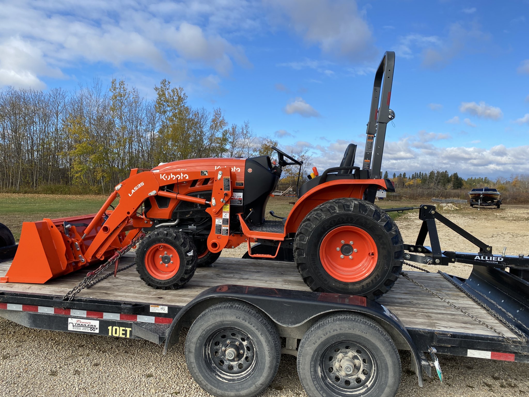

For the little extra, you also get more capability, I have 10 acres, about 4 acres of grass, I don't use my tractor for cutting grass. I have a dedicated mower but I have a 400 foot driveway I maintain in the summer with a box blade and a rear blade/ FEL for keeping it clear of snow in the winter. All points IMHO mentioned are valid including the R14 tires. They work exceptionally well in all conditions, you would also appreciate the extra weight of an LX over the B2601. Good luck on your decision.
The day it arrived. (y) Still makes me grin when I look at the picture.
