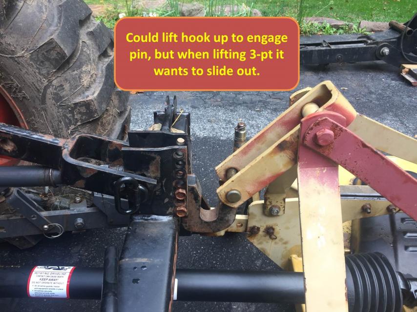

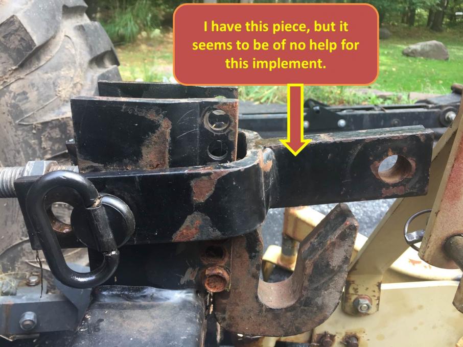

Where I'm a bit stumped is with the finish mower and brush hog. Both are older Land Pride models using the swinging upper link. My question is how are these suppose to work or what am I missing? The photos below should help clarify the issues. I'm under the impression the upper link must move to accommodate uneven surfaces, which is mandatory in my situation. Keep in mind the QH has some type of additional linkage that I'm not certain what its function is or when to use it.
The upper link position varies between implements necessitating a height change to the upper link hook. This seems to defeat some advantage of the QH. Can someone point me to the QH compatibility standards, so I can modify the implement upper linkage to be dimensionally correct?
Considering the tractor has the deluxe telescoping 3-pt hitch linkages is the QH a waste of time?

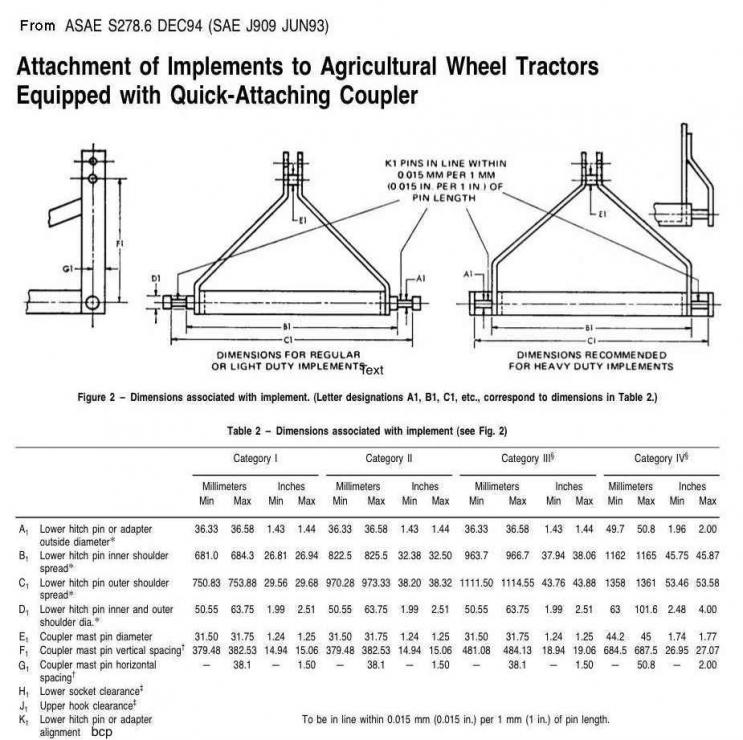

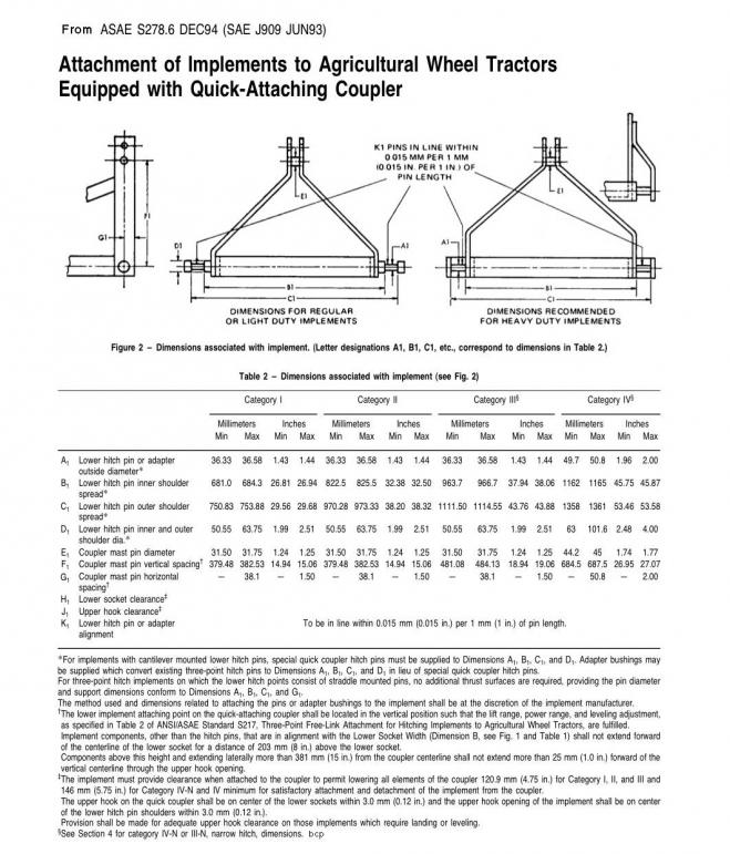

Bruce,
Thank you for the info!

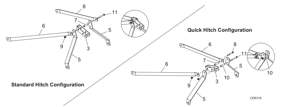

It looks like my mower is a bit different than the details in your attachment #1. Item 5 on my finish mower only has 1 hole versus the two shown in the drawing. Reversing the swinging coupler causes an awkward angle to be created since the hole is positioned higher. There's not enough room to simply drill a second set of holes with the current setup. I'll give it some more thought to see what can be done.
Anyone have any other suggestions?
FYI... Stopped by my local Kubota dealer thinking they would have some suggestions/solutions since they also carry Land Pride equipment. But no luck. They are not aware of any conversion kit, solution or work around. I'm not giving up that easy.
Keep the ideas coming!

you might try to remove the braces to the top link extension then connect the hook directly to the horizontal pin adjusting the height of the hook up or down to be able to connect and lift the attached unit unfortunately not all attachments are not a standard height for the hook link I had to modify the lift pin setup on my snowblower now i can hook up all with relative ease with some smallvertical pin height adjustments good luck

I think that the Y part needs to attach to the mower swinging part. Then you put a pin in the open end of the Y and your hook will pick that pin up.

Russell King is correct -you have everything needed. The top link for a rotary mower is designed to "float" and will only come into play when the mower is either picked up by the operation of the 3-point lever or if the back guide wheel drops in a hole. This "float" will keep the mower following the lay of the land.
When using a rotary mower remember that its rear depth is set by its rear wheel(s) and its front depth is set by the tractor's 3-point hitch so keep some slack in the top linkage. Typically the front dept is lower than the rear which helps keep the material from being cut many times and using more horse power and fuel then needed.

You could use a piece of chain for a top link, as said in prior posts all it does is lift it. As for dimensions for the GH can you make all your implements the same as your ballast box?
