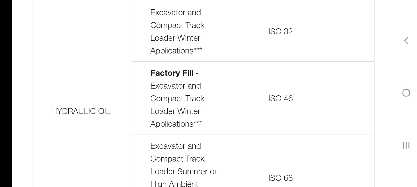

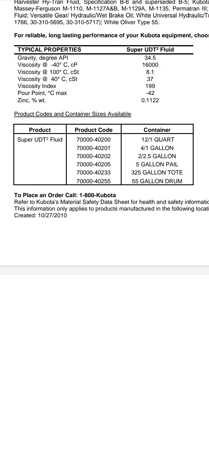

I'm not an expert on the subject of hydraulic oil...but I found this information. with respect to oil viscosity and ambient temperatures.

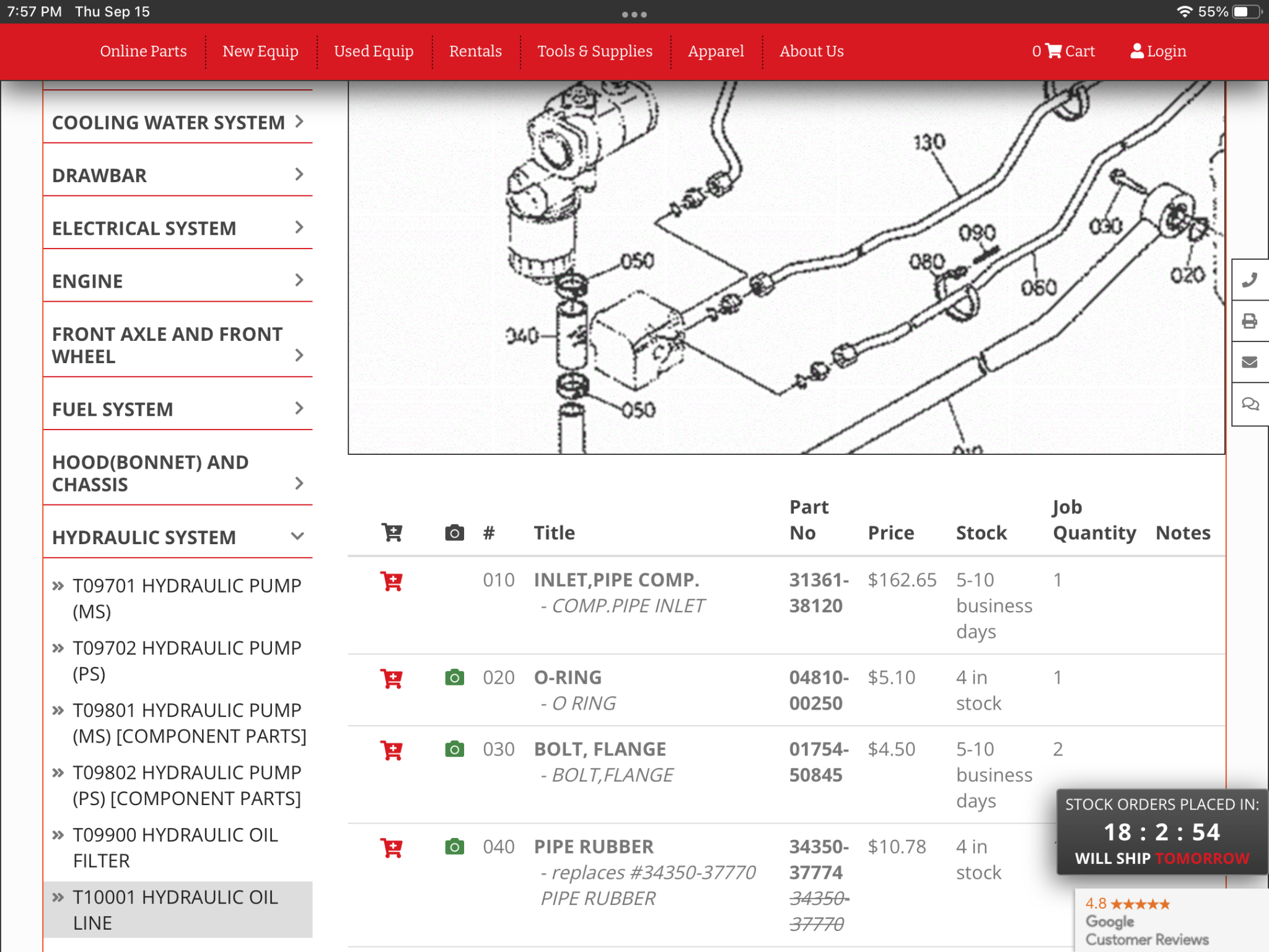

The suction hoses tend to be a problem as these units get older. They can crack or get too hard to make a seal and allow air in. Part # 040 . Don’t forget new clamps if that’s the issue… part # 050
