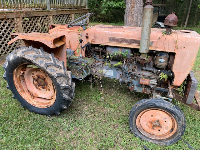

Just a brief hello from a new guy from Texas. I am retired at 67 and about to start another restoration - fun project. I have an original L200 I want to see if I can get running again. I have restored two tractors previously; a Ford 8N and a big old Case 1070. Both were as close to perfect as I could get.
This little Kubota has been sitting about 15 years on my FIL's property. It was running when parked. I was the one who parked it 15 years ago. LOL I have two other newer and larger Kubota tractors for daily use around the ranch. This little guy was calling out to me to rescue him from being swallowed up by briar vines and exposure. I am aware of the gray market tractor problem, so I hope it will need minimal parts. I know it will need a new starter and alternator as they are missing in action. I vaguely remember that something happened to the clutch linkage, as we used to pull start it and I remember a small mishap when my dear wife took off across the pasture doing about 40 mph in my truck pulling me on the tractor. I was flailing about trying not to fall out of the seat while screaming for her to stop. LOL
Anyway, I would appreciate any and all advice as I get deeper into this project over the Winter!

I don’t think the L200 was gray market so you might want to verify that it is or not.
Good luck with the restoration. The fuel tank is probably rusted on the interior and will cause trouble if you don’t get it cleaned up and coat the interior!
There is a salvage yard in California that has many parts if you get into trouble with obsolete parts.

Thanks for the welcome! I will for sure clean up the whole fuel system before trying to start it. I don't think it had a water intrusion problem as I had the exhaust covered, but I will still pull the glow plugs and take a peek into the cylinders with my bore scope. I don't see any water in the oil, but I will know for sure when I drain it. I do remember that it had a really good and strong lift for the rear arms, and I'm hoping that is still the case.
I was under the impression that the L200's were gray market and the subsequent L210's were not. I know that this one is an original L200 with the headlights on the fenders etc, and it was the very first model of Kubota Tractors sold in the USA. I think that these are fairly rare these days when compared to the L210 model. Gray market or not, the parts are still getting hard to find. I can manufacture minor items, but major assemblies might be a problem. One way or another, it looks to be a fun spare time project!

I looked at the Kubota USA illustrated parts lists and it does show the L200/L210 in a combination list so I believe that it is a valid USA model.
But while looking through the illustrations, I think I saw that the large round tank is both the fuel tank and a hydraulic fluid tank. Then the transmission and rear end are also a wet sump but not used by the hydraulic system. That is interesting since my L185F uses only the transmission/rear end as the sump.
Would you confirm that the fuel tank is also the hydraulic tank?
They also have a wiring diagram in the parts lists- another interesting thing.

You are correct about the fuel tank and the hydraulic tank being one piece-dual tank design. The hydraulic system has separate lines that run along the exterior of the tractor to a self contained lift cylinder mounted under the seat. Could you send me a link to what you are looking at? Thank You!

Here is the Kubota USA site for illustrated parts lists (KPAD). You have to agree to their terms and search for your model number.
There is also a version at Messicks (on line dealer in the north east US). It has the advantage of linking to their parts database for availability and pricing. You can also (sometimes) see what other models of tractor use the same part as yours.
