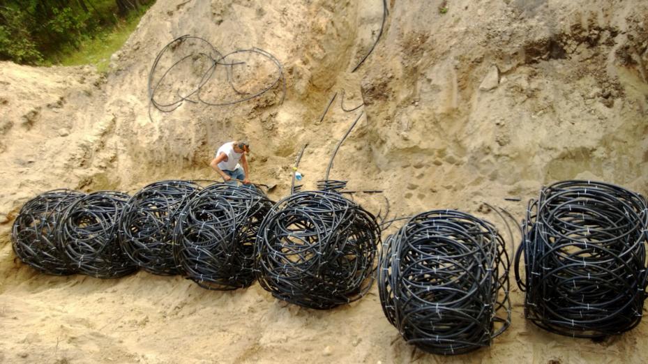

Did they roll out the balls of pipe , or were they buried like that?

If you look closely at how the rolls are prepared you will see that they are zip-tied in loops rolled together. I was not here when they installed them but I would guess that by the looks of the rolls that they rolled them out with the loops left intact. The area that was excavated was quite large - I would guess that it was at least 50' wide x 50' long x 10'deep.

If I was guessing by looking at the pic, they unrolled those balls with the loops laid out overlapping each other some. Surface area is what you are after, more surface area...more heat transfer. The trench was probably slightly wider than the ball of pipe.

The trench was at least 50' wide x 50' long x 10'deep. The pictures are of the pipe in the bottom of the trench.
Then they made a well bed. Rolled them out next to each other, connected them and probably had one ditch back to the house. I've worked on some before the loops were in ponds, one with a fountain in the pond.
