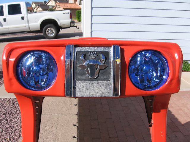

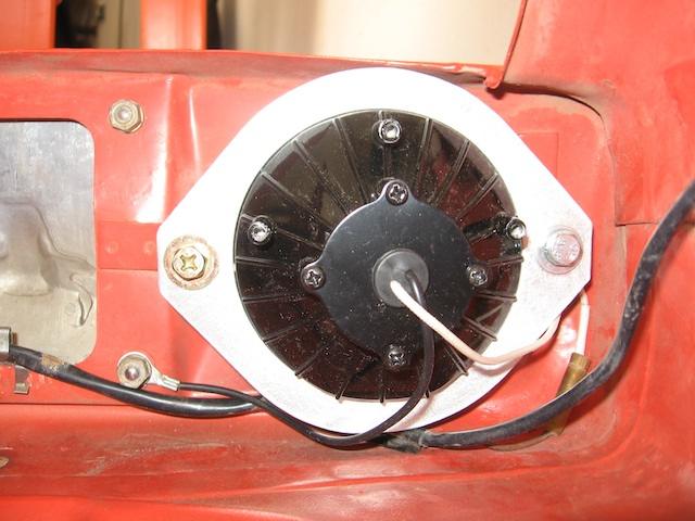

I thought I had posted on my replacement headlights for my B7100, but several searches yielded nothing. Anyway, I found these driving lights at O Reillys, glued a large o-ring (or maybe a vacuum cleaner belt?) to the front, and made new brackets to clamp them in place. They are about 100 times brighter than what was left of the originals. I think I still have the box they came in for brand, model#, etc., but it's 150 miles from here, and I have no idea when I'm going there next. Sorry.:eek:
