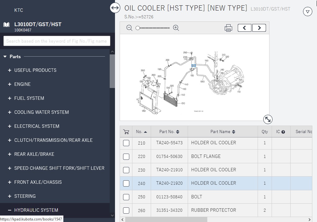

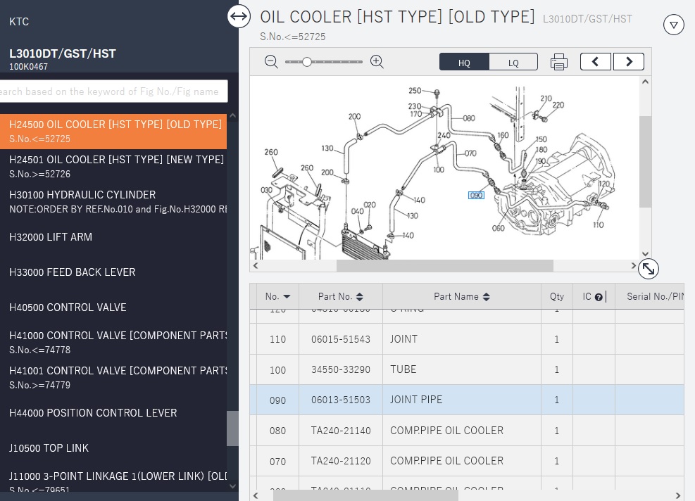

Looking at parts lists, if your serial number is 52725 or below, those two HST oil cooler lines have couplings 090 and 160 in them (see below) which look to be accessible without taking out the tank and shutter plate. But higher s/n tractors apparently don't have couplings. I don't see a coupling on your closer pipe - but maybe with both ends disconnected it would move enough for the valve cover to clear it? Might need to drain trans oil - maybe pipe would flex enough with just the front loose?
for s/n < 52725
for s/n 52726 and up
for s/n < 52725
Yes, mine is the later one, I have the fronts disconnected, they move but not enough, the end on top of the tranny is unreachable to turn.
