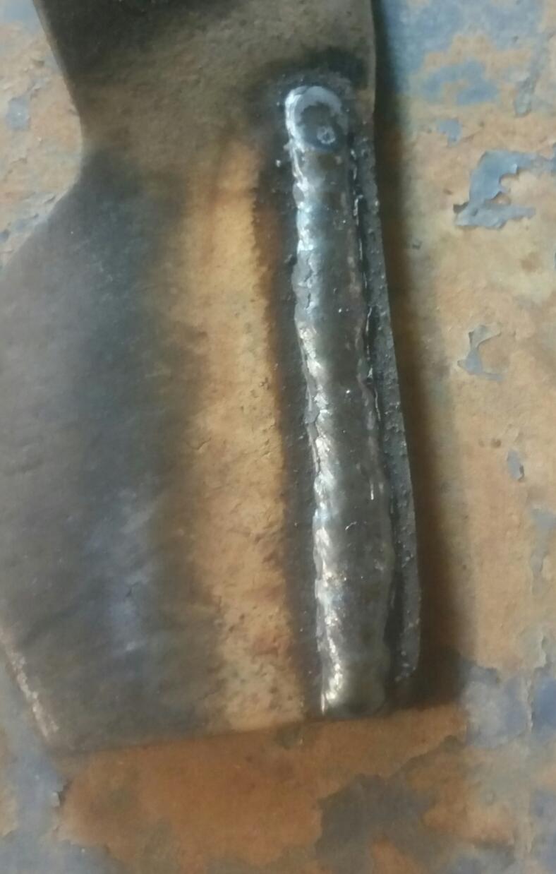

This is what happens when a regular mower blade hits a terracotta chimney liner. This blade is in the scrap pile, not going back on the mower.
I ground it down a little. I think the welding rod may have ran so hot that the base metal and hard face rod mixed. I was actually able to grind it down with a flap disk.
Raw hard face weld.

Now that it's warmed up some I got to use my riding mower.
Over the course of about 2 days the blade wore back to the hard face rod. Now starts the true test.
The actual blade I hard faced looks almost identical to the one in the picture.
Last time I pulled the blades off to sharpen the test blade had worn back to the edges of the hard face bead.
The hard face bead appears to definitely be more wear resistant than the original metal. I have one hard face blade and a unmodified one. They appear to wear at the same rate as far as I can tell. One more long day of mowing will tell me for sure if the hard facing does anything.
