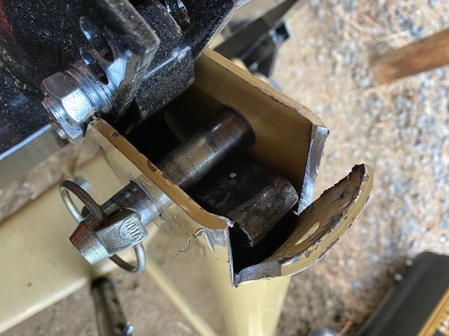

I made the modification (see image) and I also ordered a new upper hook that sticks out about 1/2" or so, which will do the trick. Thanks for your help and suggestions, very much appreciated.

Interesting, feel free to include your fix to this post. LP blade # and a wider image also appreciated.

Hi Krush... no, the problem was that the hook was not clearing the back wall of the implement, so I got out this am and cut it so it would clear... that worked, but the upper hook is still too far back, so the new hook should remedy that... won't be here until after the Holidays, so I have to plow my driveway (250 ft gravel/dirt on a fairly steep hill) as it is... I called Harbor Freight and spoke to one of the tech guys and he thought as long as the lower hooks are in and the latch handles keep them in, I should be OK until the larger upper hook is installed.

I believe the HF hitch is similar if not the same as the Northern Tool QH that I have. I had to hit the top hook with a grinder for a bit to open the hook up enough to let my LP BB1260 seat right. The top hooks are known to be a little too tight........ not sure if you encountered that but I figured I would throw it out there.......as others will hit this thread using "search" and the more solution options the merrie

Hi River... yes, I agree... I just decided to take the easy way out for me...
