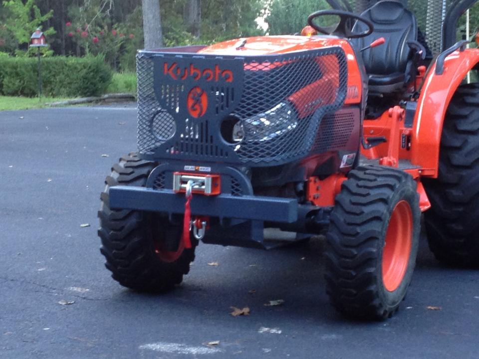

I bolted some angle iron on and welded the expanded metal to it. Did not have to drill any new holes.

Does that tractor belongs to the military? :eek:
Bomb removal team? ;)
Seriously nice job!

Alansz40 nice work! How do you fuel it up, isn't the cap under the guard?

It flips forward and lays straight out the front. I can pull one pin out and the whole thing lifts off.

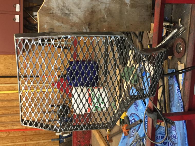

Jan 3, 2010
Jarrettsville, Maryland
Here's how I made mine for a B3030. Getting the angles correct was the toughest. I had scraps of the screening and used several pieces and welded them together to make one full screen. I have a 2" receiver mounted on the front of the tractor where I can attach/detach this brush guard from the tractor as I only need it when I'm using my grappler. I apologize for the sideway pictures.
