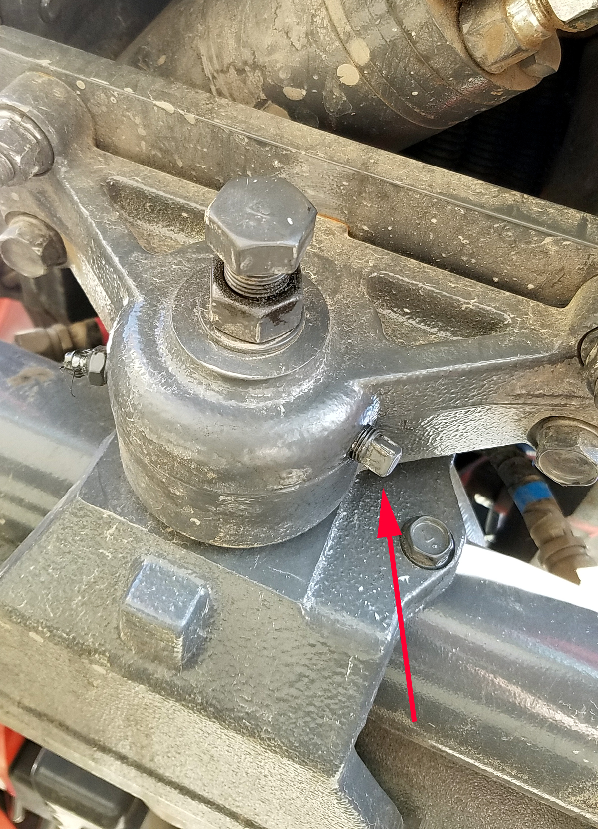

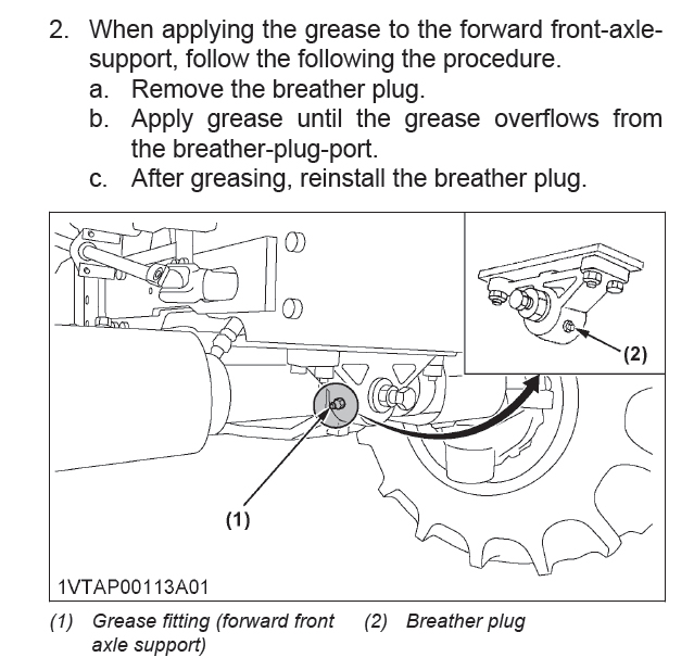

My MX6000 has a square drive plug that needs to be removed before greasing the zerk fitting at the front axle pivot point.
What does the bearing sleeve look like on the inside for tractors that have the zerk/vent arrangement? Is there a grease channel or other groove that runs between the zerk and the vent hole? Adding the zerk and vent may be a good mod for my tractor front axle.
Thanks in advance.

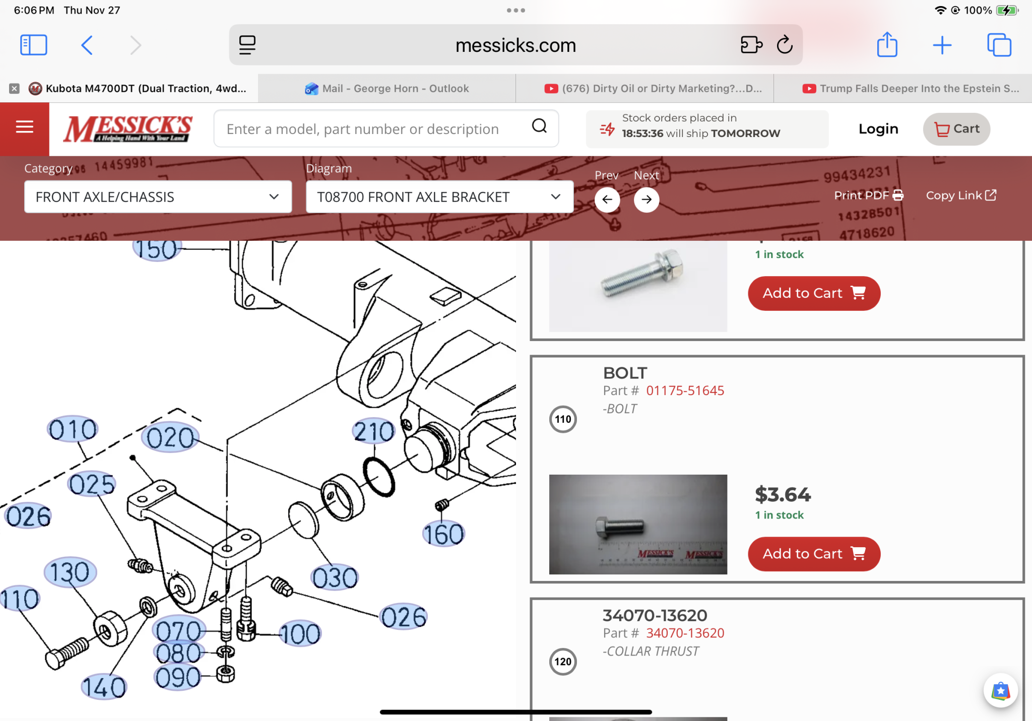

The front of those axle-brackets have a lock-nut (130) and threaded-pivot/bolt (110) which is adjustable to take up “slack” from the wear-point. That adjustment-bolt should be removable… if you want to allow an “escape” path for excess grease. (I’m presuming that the disc (030) will allow grease to slip-by.)

@GeoHorn thanks. Thinking about removing the front and rear brackets and drilling them for zerk + vent plug.
