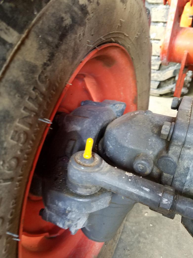

I use caps to cover each zerk after greasing and change the color each time. This helps ensure I did not miss any and I do not have to clean the zerk before greasing. No grime builds up on it between greasing.
Great idea! Where do you get the caps to cover each zerk?

They are end caps used in the telecommunications industry to cover the ends of air and filled cables.
I don't know where you could buy them, I have dumpster dived for bags of gray, yellow, blue and red ones here at work when we clean out.
Sorry, just never had to look for them to buy.
