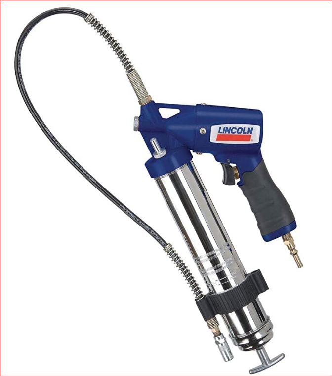

I have a Lincoln pneumatic grease gun using the L-N-L..... and small manual gun for those hard to get zerks.
I have a new (unused) Lincoln pneumatic grease gun!
The requirement for available electricity, and a compressor, plus dragging a long pneumatic hose around in the dirt, is nothing short of a 1950's era nuisance in my opinion.

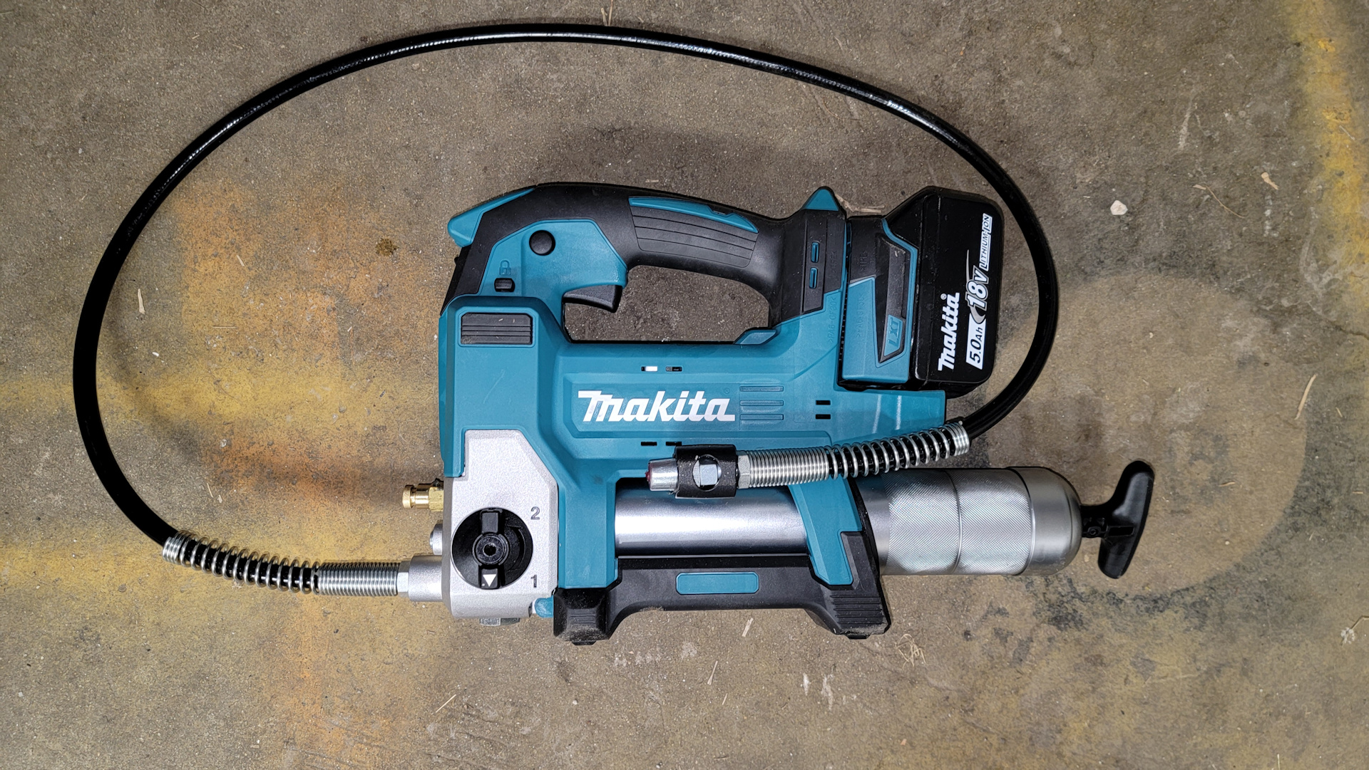

I have put a case of tubes through the new Makita I picked up and it is fantastic. It has 2 speeds for real fast or high pressure, a nice bright work lite and uses all the same batteries.
A great looking tool!
I think somewhat nicer than my 18V DeWalt, but my DeWalt was only slightly over 1/2 the price..

I tried out a cheap-o pneumatic Harbor Freight grease gun for about $20 and it works out great. I have air in my garage and barn with hose reels so it's no big deal fighting the air lines. I may pick up another gun or two for different greases. If you have air these work great for the price. Drop a cartridge in, pull the trigger and grease comes out, it not rocket science. The locking tip I put on it cost more than the gun. I still have a couple of old manual guns ones for when I need them.
