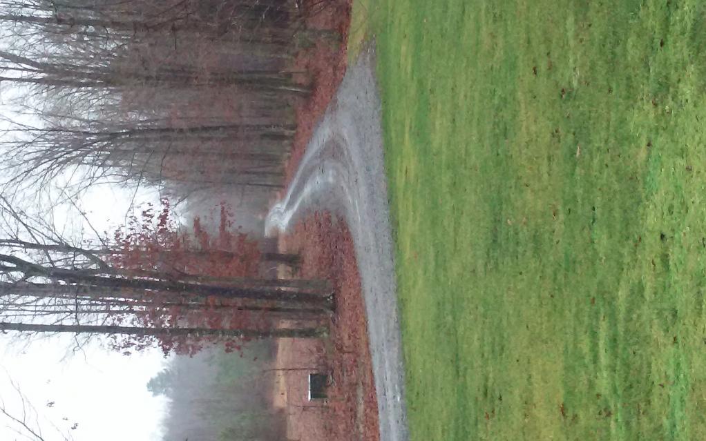

I'm looking for some advice on different gravel options for my 900 foot gravel driveway? 5 years ago I had 56 tons of #57 blue stone tailgated. The driveway has taken some abuse since August with 22.60 inches of rain and one 3 inch snow and is now in need of some maintenance.

TD - first I rotated and zoomed your picture.
Was making me sick tilting my head....
Before I added anymore stone, I would re-do what you have. Looks like quite a bit of stone along the edges.
Do you have a box blade? Set the scarifiers down a little, with JUST a little bite on the front blade of the BB, then follow with a longer top link, pushing more on the back balde. Couple passes, you'd be surprised what the result might be.

Great suggestions already. I agree, get the current surface flat and packed before adding more material.
In reading your post initially, I thought you might be asking for what other materials might be better. Problem is, mixing materials often creates problems as materials migrate no matter what you do. From the picture, your gravel reminds me of the railroad ballast we used to set our ties in. Over time, it locks together but rain can undermine the rock bed.
You are probably going to be limited to the same material when you get done planing the current surface. That, or asphalt paving the new layer of rock.
Not sure what soil conditions you have in VA but, a second layer of rock might solve your issues for some time. Rock that gets pressed down into the soil serves as a base for the new material and eventually, the soil gets pretty solid, assuming your drainage carries the water away. Pooling anywhere on or along the roadway is not a good thing.
