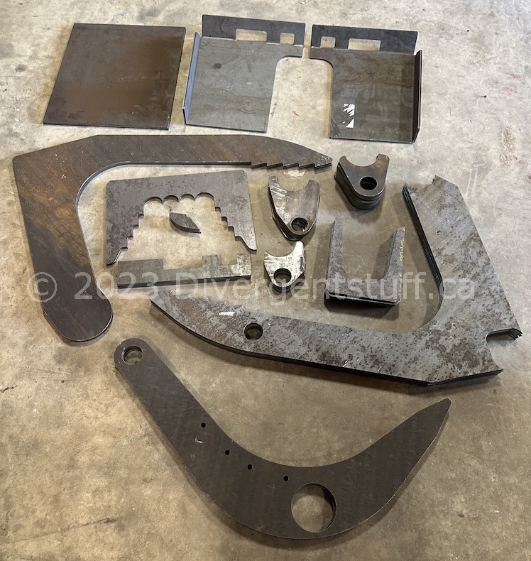

I just started fab on a new twin lid grapple design. Key features
* All AR400 laser cut parts in 0.25, 0.131 and 0.375 inch thickness
* 8 inch tine spacing, bottom tines are about 32 inches deep on the inside dimension, jaws open about 39 inches, overall about 68 inch width
* Designed to handle either 3 or 2.5 inch utility cylinders with 8 inch stroke
* finished weight estimated 750 lbs using 1/4 inch inner tines and 3/8 grapple
* 10,000+ lbs design load capable for use on SS or CTL, this design is to be tough yet light weight, great for my M59's ~4,000lbs lift capacity
* I've tweaked the design to allow me to grab and pull logs from the ends, pick/grab smaller 6 inch diameter rocks, grab odd shaped items like root balls and large branched logs, be able to rake the ground to pick up small branches, a larger base fork to make hauling firewood logs easier and to be able to grab more brush in one bite
* grease-able protected pins that are locked in place with retaining bolts
First image shows a 3D rendering. Second image shows the flat pack of parts. Third image shows the initial layout for welding. Fourth image shows my old single lid root grapple I bought which was heavy and designed using 1/2 inch mild steel.

How many users would want to fab their own grapples if they could select and buy all the components and have it shipped as a flat pack kit? The laser cut parts are the hard to get items. Stuff like structural tubing, fittings and cylinders are better sourced locally instead of shipping parts from Canada that I get out of the US. I focus on locally sourced materials. My laser shop takes about a week to cut parts for me and finish is pretty good. Shipping would be on a 32~36 inch pallet shrink wrapped with total weight of the flat pack parts about 450 lbs for what you see in the image above.
My thinking is that there are probably guys like me who wouldn't mind an ikea approach to grapple attachments. I keep seeing all this cheap sh*t imported stuff out of china with poor designs, crappy welds and thick globs of high hide paint and think no, I don't want to waste more time fixing someone else's problems. Bite the bullet, do it now and make it the way I want it. If I could find the parts I want online and buy them I would - but I can't find them.
Obviously buyers need to have some skills and tools at hand to do some welding/fitting/grinding etc. Price is always the question. Shipping LTL from Canada isn't cheap so the more I can fit on a small pallet the better. Steel prices are out of this world at the moment, however, I can get 10 sets of parts cut cheaper than one offs. Economies of scale blah blah blah.

One issue I see the the weight of you design. At 750 lbs that is half of what I feel comfortable lifting and moving with my LX2610.

Keep in mind I've designed this particular grapple for my M59 which weighs close to 10,000lbs with cab and BH. This particular grapple could also be used on a SS or CTL. This would be way overkill for a SCUT. I've been digging out root balls that are between 2,000 to 4,000 lbs - much heavier than than a SCUT.
If I were doing this for a SCUT I'd probably go to 3/16 thickness on the tines and webs and 1/4 on the structural tube. I'd also use less tines spacing them farther apart. You also don't need twin lids on a SCUT. You'd probably want something in the under 400 lbs range assembled.
The concept would be able to choose your tine/parts thickness according to your wants/needs.

Weight is a big factor and perhaps it all could be cut from 3/16" material ? If so, you also can 'nest' the parts for minimal waste. 'Computers' generally do that nowadays, 3 decades ago I asked the fabshop what size the stock plates wee and then 'tweaked' my energy control panels for just a sliver of waste. YOU buy a whole sheet, pay for product AND waste. Something to consider..
query. Can you reduce weight by putting holes into the tines? Look at them as 'trusses' not 'flat bars of steel'. You have a lot of tines, so saving even 5# a tine adds up fast !

Yes cutting holes in the forks reduces weight. Cutting costs are by the profile inch so more cuts means higher price.

Another thing to consider is the welding of the AR 400 steel. It is not very forgiving. Preheat and weld with low hydrogen filler followed by a slow cool is the proper procedure. You would/should include instructions with your kit or face an onslaught of unhappy customers when the welds start cracking. Just my .02
