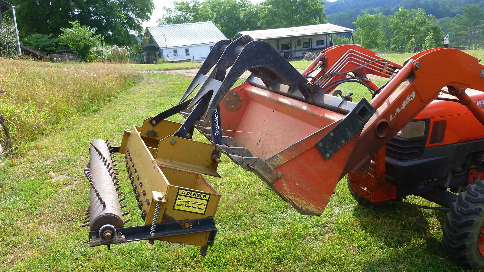

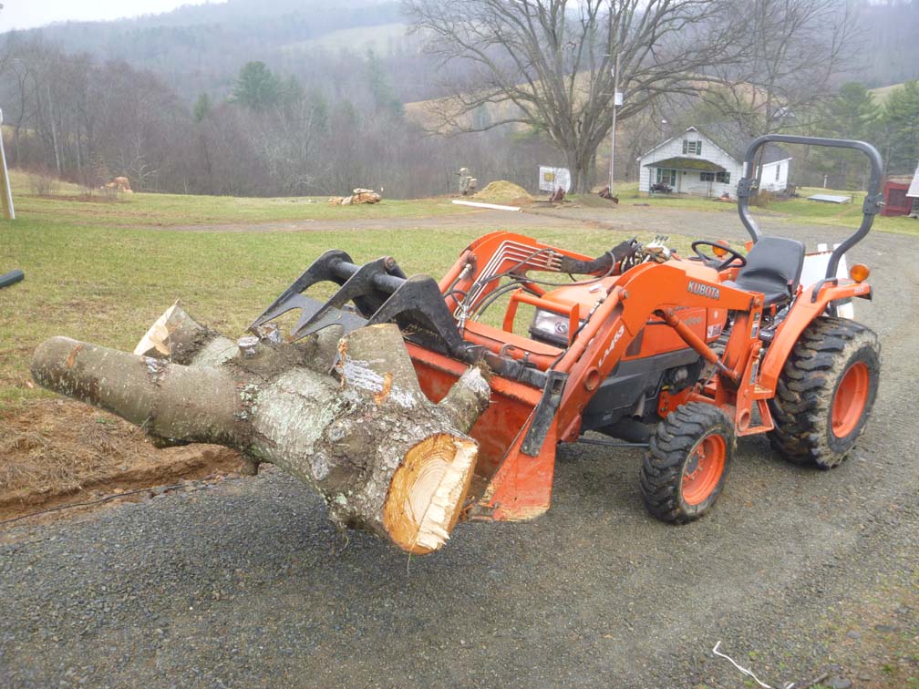

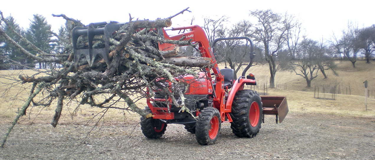

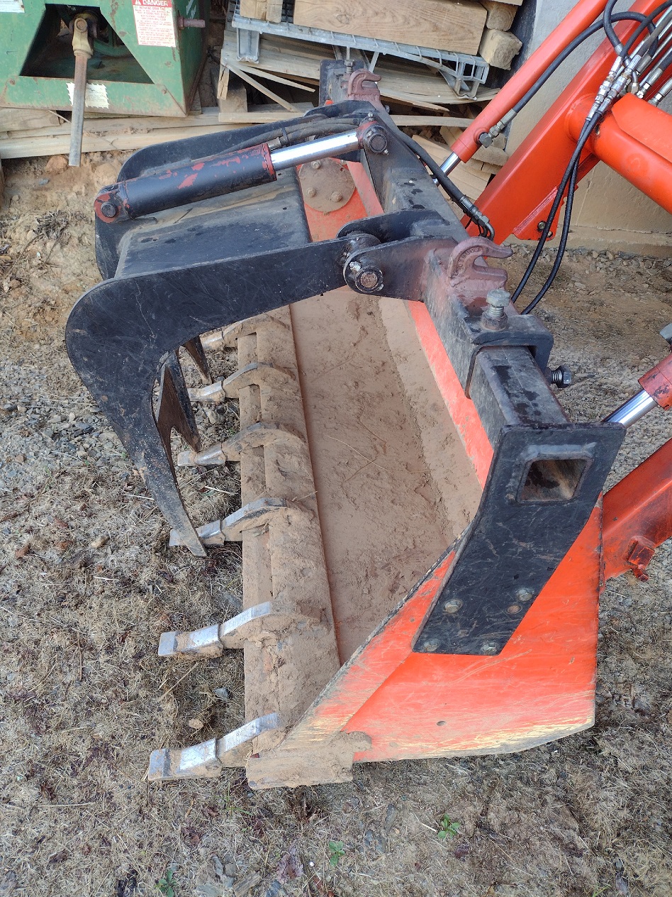

There are "kits" that would work, takes the guess work out of what you need... https://www.wrlonginc.com/product-page/electric-hydraulic-valve-kit Also, I prefer to bolt on a single grapple to my bucket so that I can still move dirt & gravel but still pick up logs and brush...
https://www.wrlonginc.com/single-dual-dualx I've got the single and love it, it adds 143 pounds so it doesn't eat up so much lift capacity. I've also got the tooth bar which helps to "bite down" on loads....
Edit Added another photo of the tooth bar and grapple....

How well do the bolt on grapples do at picking up stuff that's wider than the bucket? Seems like the bucket sides would get in the way.
That's a lot to clear... I have stuff that sticks out both sides of the bucket and could not see around the pile.
With that said, I'm sure you can carry more with EA's grapple. I don't mind making multiple trips... My bucket is pin on but the main reason I got the bolt on was the $350 price tag... although new it's $1300-ish... https://www.everythingattachments.com/WR-Long-Bucket-Grapple-p/wrl-bucket-grapple.htm

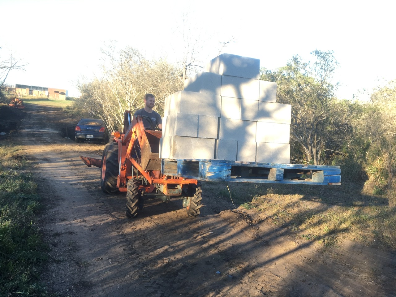

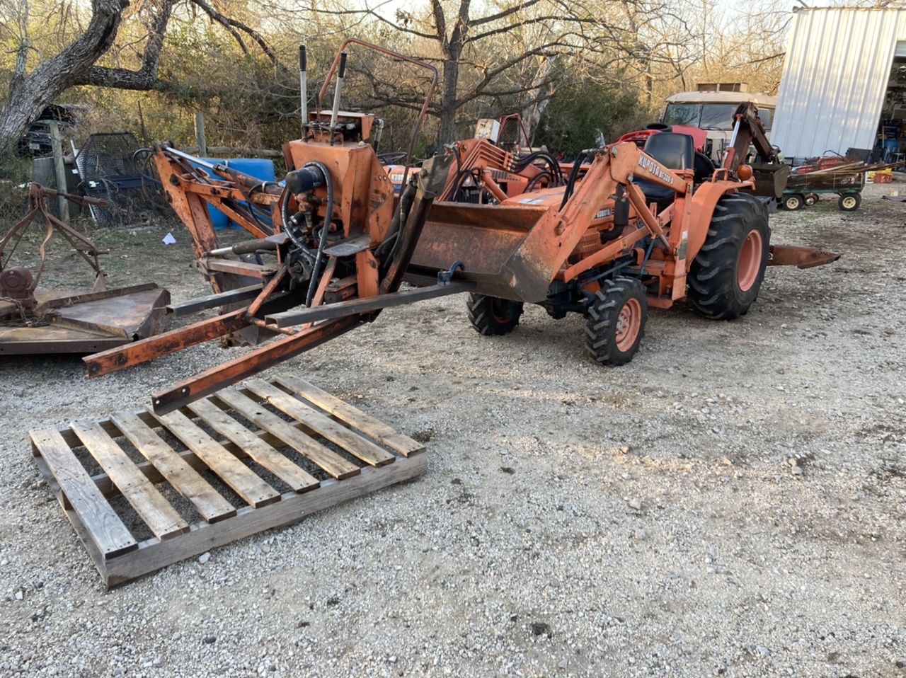

A grapple, a grapple conversion, an ssqa conversion, and a 3rd function hydraulic circuit, are all pretty 'big' hurdles for a lot of buyers and builders, whether it's the money or the tools/time/learning invested before you can pull it off.
I think some kind of bucket forks, whether it be clamp on pallet forks, or clamp on debris forks, are a REALLY good idea in the interim to make the issue a bit less 'all or nothing' until you get to your actual end goals. I built some forks which i use on the end of my buckets and they are both A: a pile of shit by most people's standards, and B: ENDLESSLY USEFUL.
I'll get to the other ones someday.. As an auto mechanic and prolific tinkerer i already have welder, plasma cutter, knowledge of hydraulics, bending and flaring experience, some hose crimping, electrical knowhow, etc etc. I even have SSQA conversion plates, the mini-skid SSQA adapter, heck i even 99% built (i need to weld on one small section..) an entire rock/skeleton bucket for the mini-skid SSQA adapter.. so im GOING to get there. But i still recommend that unless you are going to get your SSQA/'real forks'/'real grapple' in the near future, that you still consider getting some bucket forks to hold you over. You'll make a ton of use of them and likely not regret them.
The tiny backhoe was 750lbs and the partial pallet of blocks was ~1100lbs.
