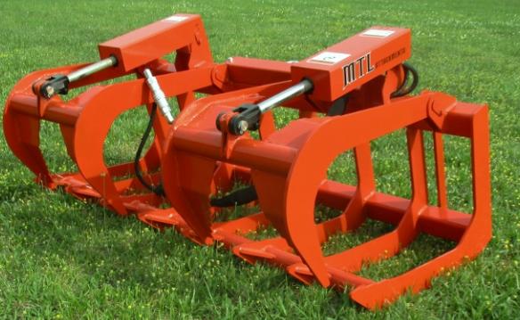

I would suggest MTL root grapple. I have one and its real heavy (1100 or so lbs). Can handle anything you throw at it and will not bend. Your FEL would be the weak spot it something happened

You guys have bigger tractors then mine, but I have an MTL 60" double lid, and my 40 HP L4240 tractor will not tear it up. It was not expensive, works fine, and saves a lot of hand work.

I also have the MTL and I agree that the loader will be the weak spot .... under a grand for my 60"

My comment comes from the ad hype of showing using a root grapple like a dozer. If you try to use a FEL and rip up roots your going to bend the FEL, the grapple will be fine.
Get any well made grapple and it will hold up, I went MTL because it met what I want it for, and I have no thoughts what so ever of ever using it as a root rake/ripper
