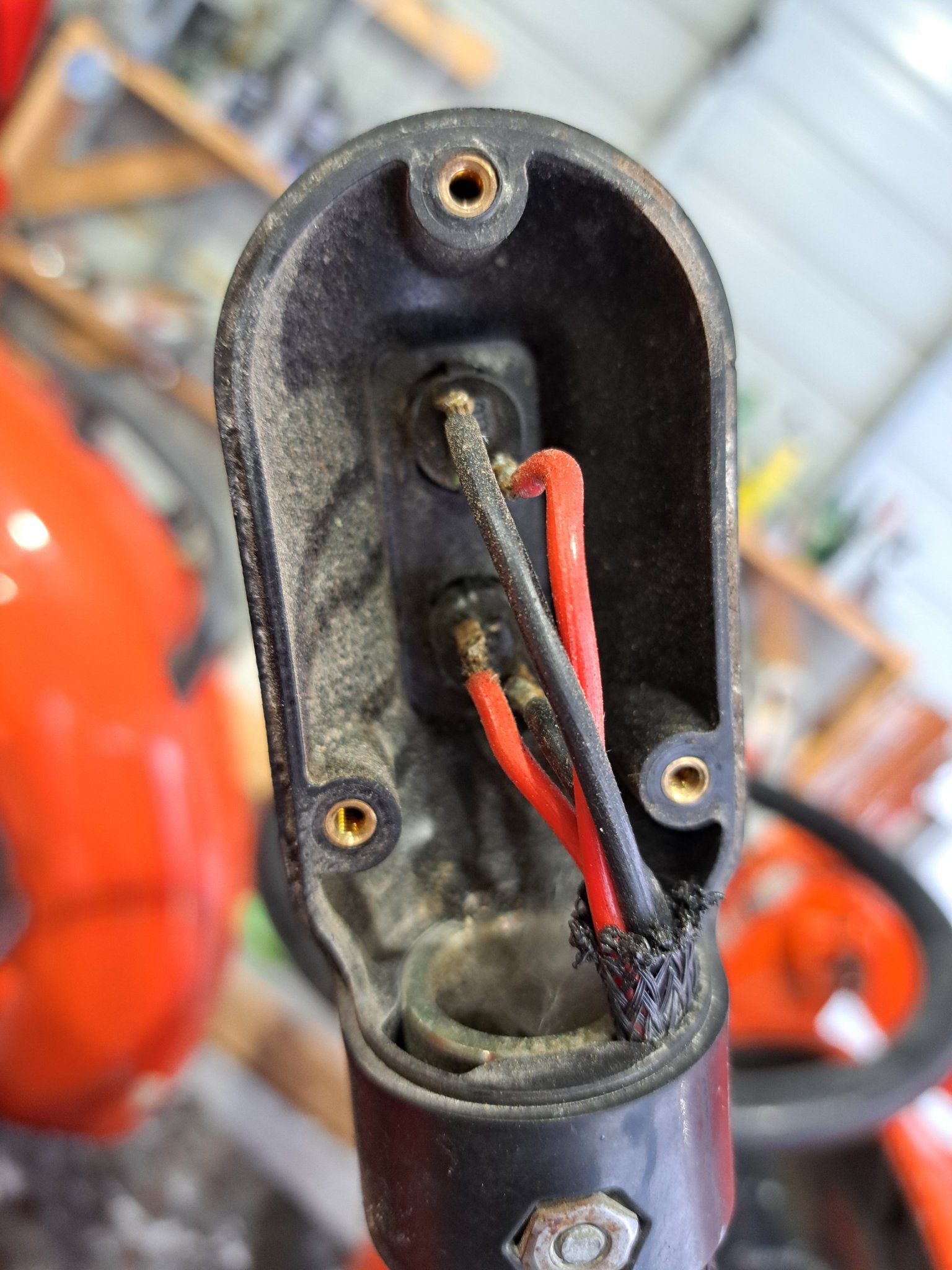

When I pulled it up to the cottage the last time, it was rainy/nasty out so I wonder if some water got into the switch housing.
Nope, that looks good and the connections look good too. Hmmmm???????

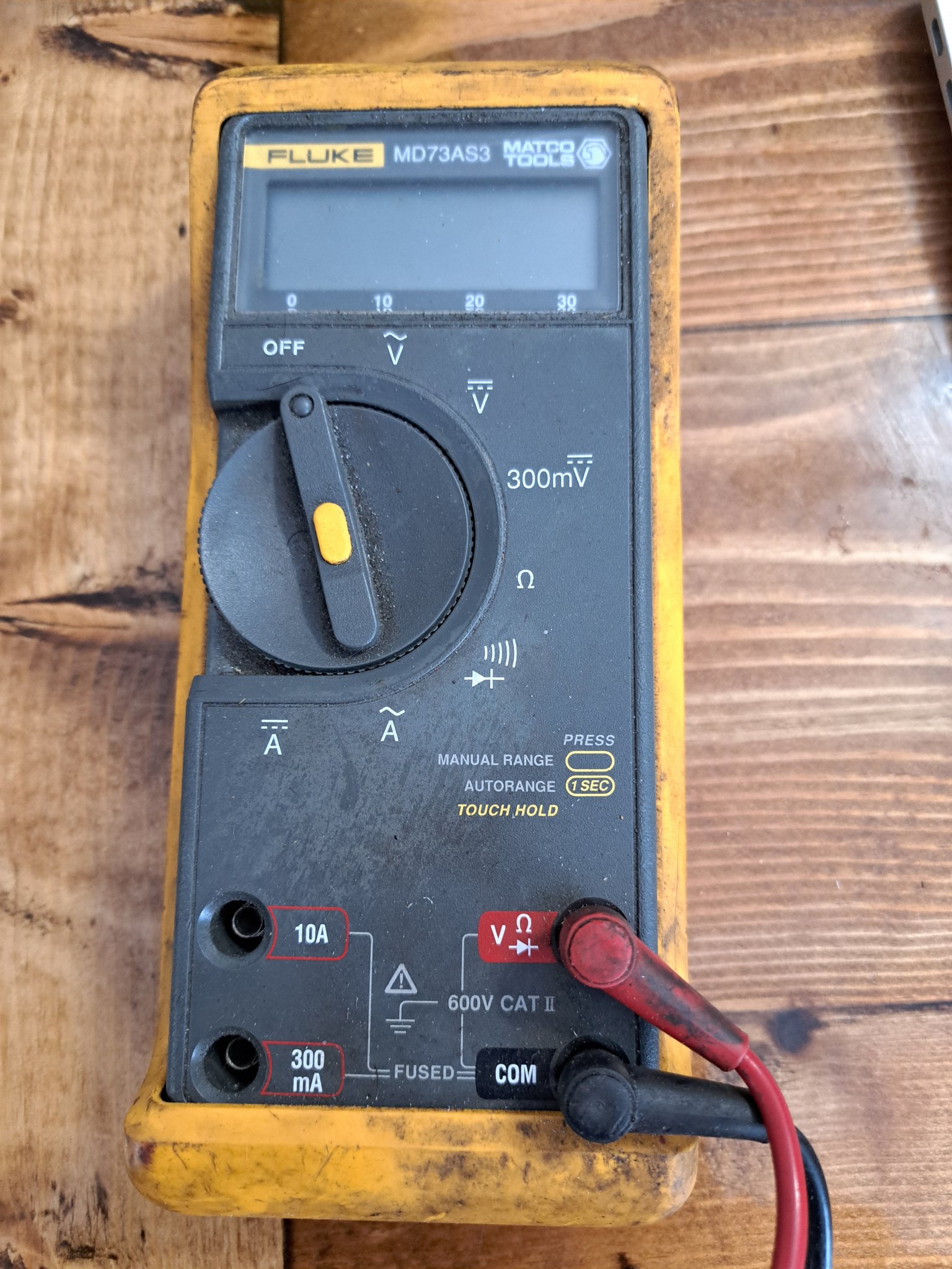

Next I whip out the 1,000 year old Fluke meter......
Good ground, but no power.....Then it hits me like a sack of hammers, "Hey dumbass, you just installed a Battery Maintainer....check that area"

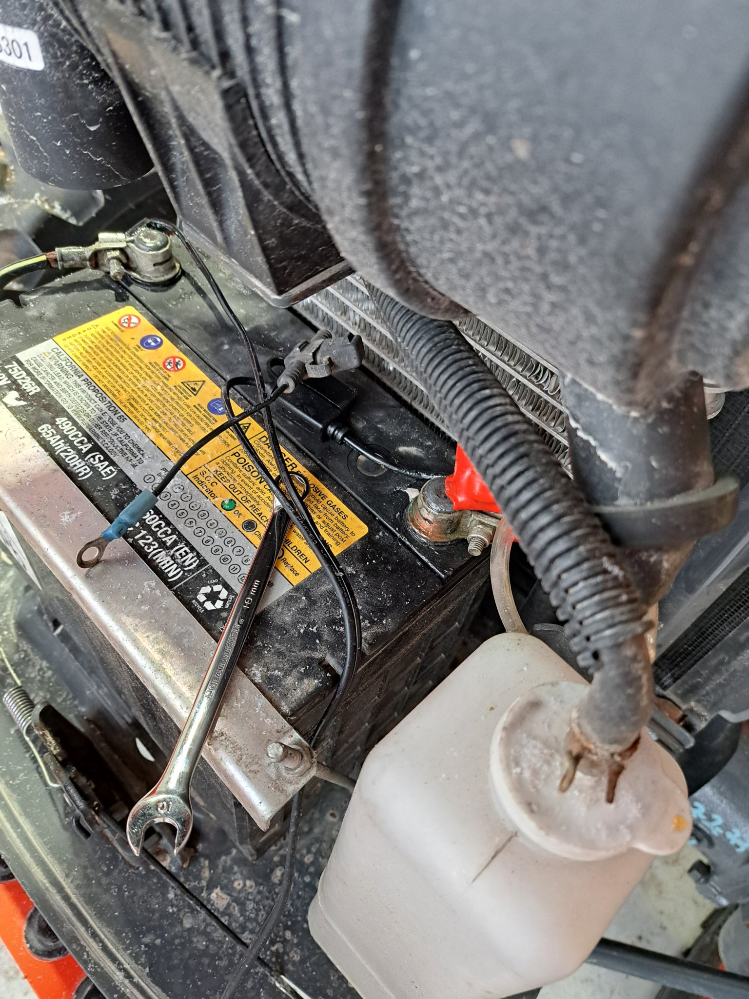

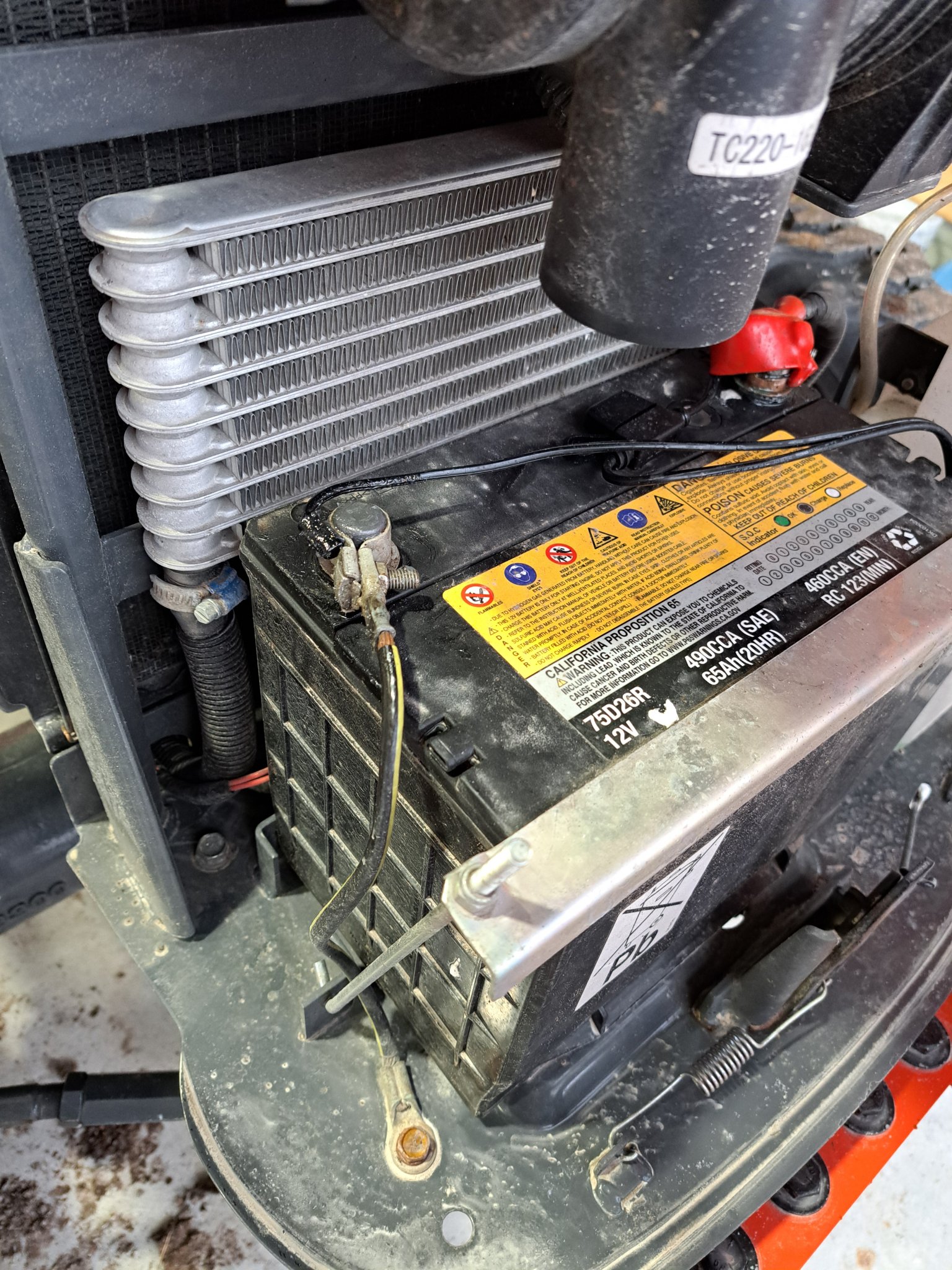

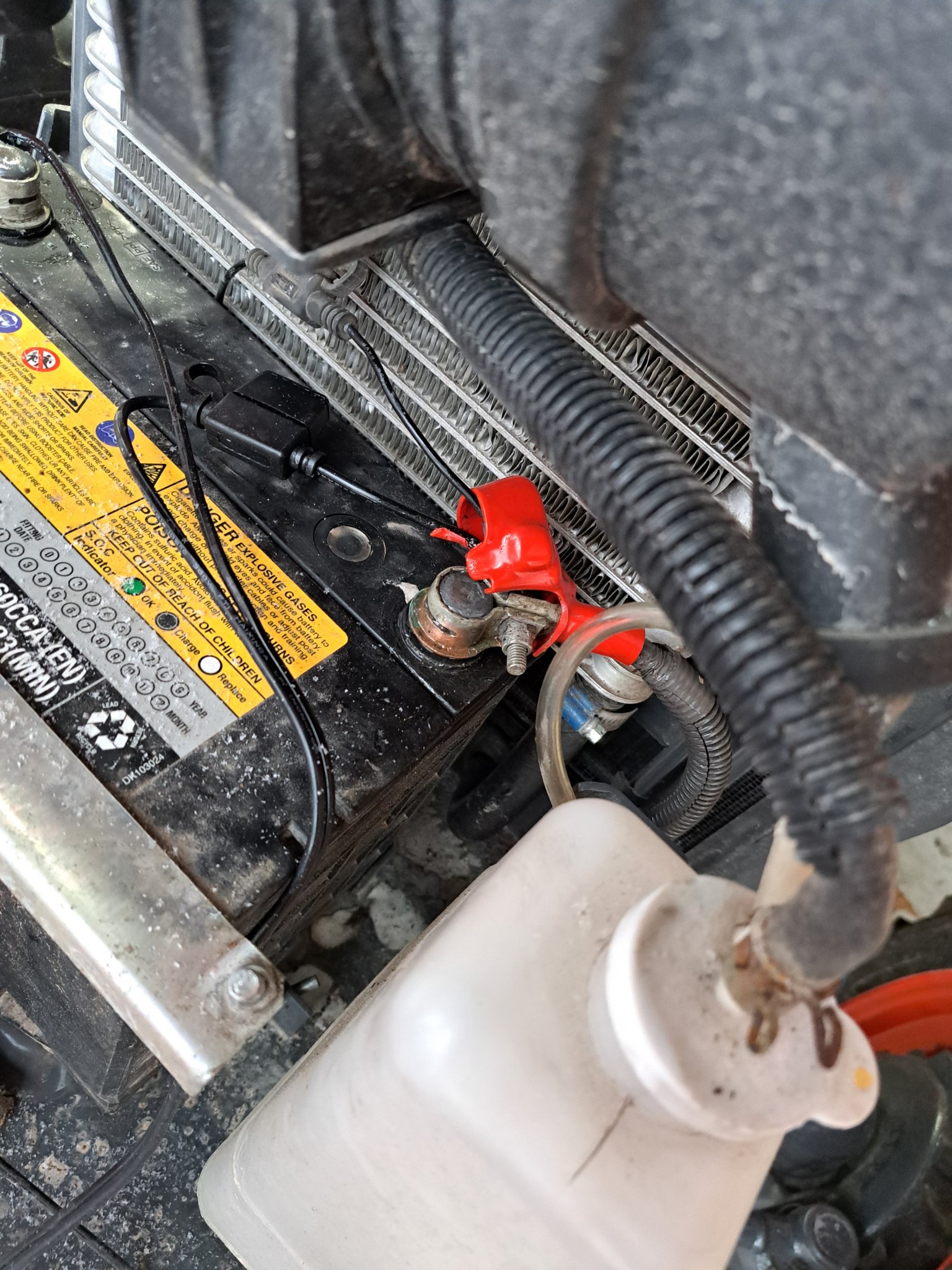

After a 1 minute inspection, I see what I suspect is the culprit.
2,916
3,566
I grab a 10mm and some dielectric grease and get to work....
A few minutes later, it's connected .
and the Grapple is working great.

My fluke 87 might be 30 years old, what does a thousand year old fluke look like? Are they made out of stone or bronze or are they made like a Ouija board?
Bill
like this....
I can't recall exactly what I paid, but it was a lot back then.
I'm guessing it was early to mid- 90's when I bought it?
maybe late 80's?
I have had it so long, I can't remember when....

My original Fluke 87 is from 1989 so closer to 35 years old. It was the first "real" $ piece of test equipment I bought. I recall it being close to $200 way back then which was a good chunk of change for a formerly young guy.
I still have it and it still works though it has developed the annoying habit of sometimes turning itself on and draining the batteries. I recently got a new Fluke 87 series 4? 5? hopefully it will be just as good.
