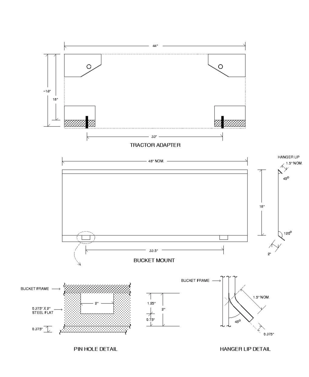

I'm pretty sure the LA344S uses the SAE J2513 standard SSQA, dimensions below:
You may need to change the hydraulic couplings to match.

You are correct. That is the bucket mounting system. How do I identify which grapples are going to fit this system? There are so many different spacings it is quite confusing. In particular will skid steer type grapples fit and if so how do I identify which ones? Thanks very much for the help.
Any SSQA grapple will physically fit. But for a BX, weight will be critical. I can't really help, but here's a link to a fairly recent thread that should help. I'm sure BX owners will reply before long.
