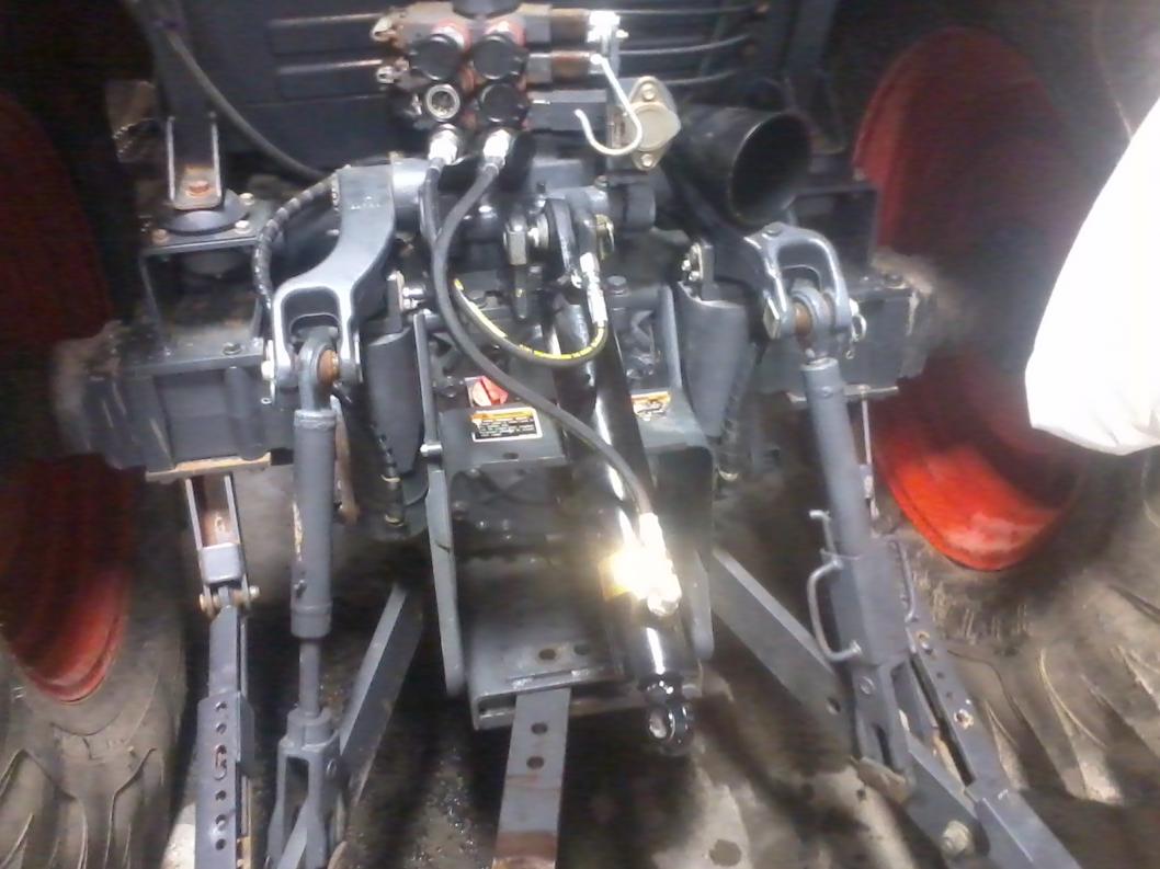

I am trying to find a hydraulic top link for my Gr L6060. The pin is 3/4" and the ball width is 1 3/4" on my tractor. From what I have researched this is a cat 1. Most of the cat 1 hyd cylinders are too short. The cat 2 cylinders are the right length and have a lot more push and pull power but the ball width is 2". (I only have 1 3/4") So how is the spec cat 1/2 for my tractor when the ball on the cat 2 is too wide to fit on the tractor. Its not the pin size. I understand I can get a cat 2 to cat 1 bushing it is the width of the ball. Am I missing something.

I put a Cat II hyd top link on my L3901 - Same deal the Cat I did not have enough stroke or enough power. I used superglue and glued the bushing into the heim joint. I then ground off the excess with a grinder. Works great.

Just built one for my M9540, bought all the parts from the surplus center. I used a 2.5 inch cylinder, and may be a little light for my tractor, but time will tell.

Got them from the surplus center. They have some ready made's with smaller bore cylinders, but I bought a Cat 2 cylinder which required me to cut the cylinder eye end off and weld on a longer eye for clearance
https://www.surpluscenter.com/Hydraulics/
Bought all the parts individuality, hoses and all fittings
This is the ready made's, note (say top link) they have a longer fitting on the cylinder end, and some have check valves
https://www.surpluscenter.com/Hydraulics/Hydraulic-Cylinders/Tractor-Top-Link-Hydraulic-Cylinders/
This is the one I got and modified
https://www.surpluscenter.com/Brands/Wolverine/2-5x12x1-5-DA-Hydraulic-Cylinder-Wolverine-WWSB2512-S-9-12231-12.axd
