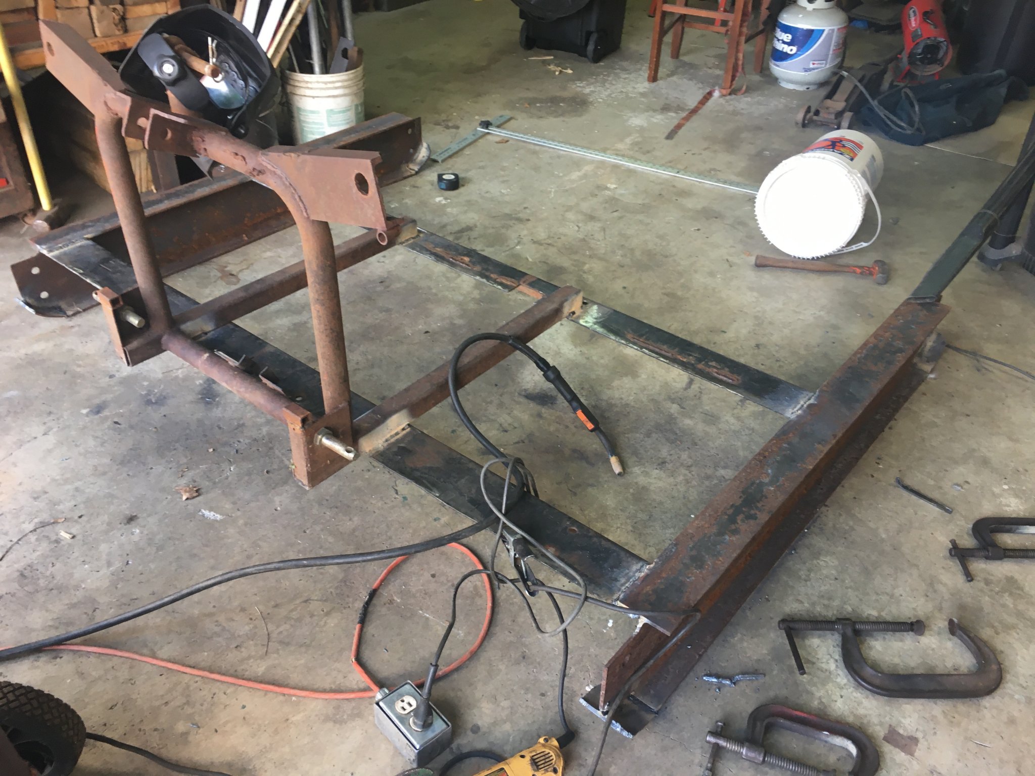

Pulling this behind a L3130 picture befor comp. 250lb plus after i finished it / graded about 1 acer at my sons / clamped on a 6' I beam & straped on 10 cement blocks hard ground pulled it no problum
