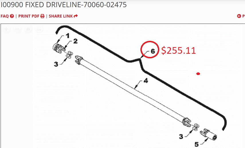

Is the shaft that bent part #4 below?
Likely replacing the complete assembly #6 is the way to go.
You need to determine why the blower became disconnected. It should not happen and it will be a User rather than a design issue.
Since you need to buy the shaft from a Kubota Dealer, ask if they make house calls where they could install the new shaft and see why the blower became disconnected.
At a minimum you need the shaft. The mechanic can determine if other stuff is bent/broken before he damages the new shaft whereas if you install the new shaft yourself, should you miss something, you will be the one damaging the new shaft.
