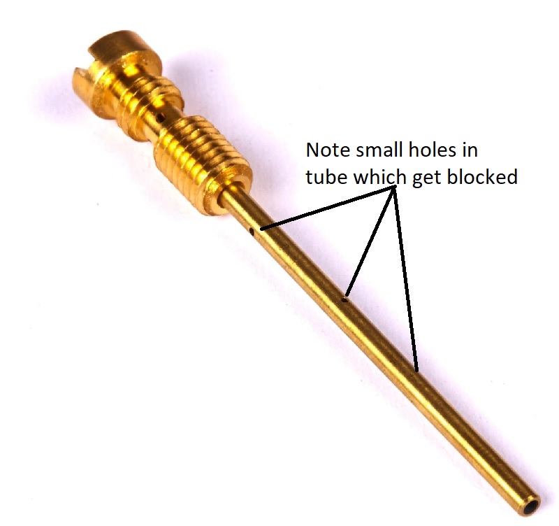

Do not know about the carb on your engine but some have a long emulsion tube buried under the main jet. The tube has tiny holes along its length and as they get plugged the engine begins to hunt.
Do not think you can clean this tube without removing the jet
