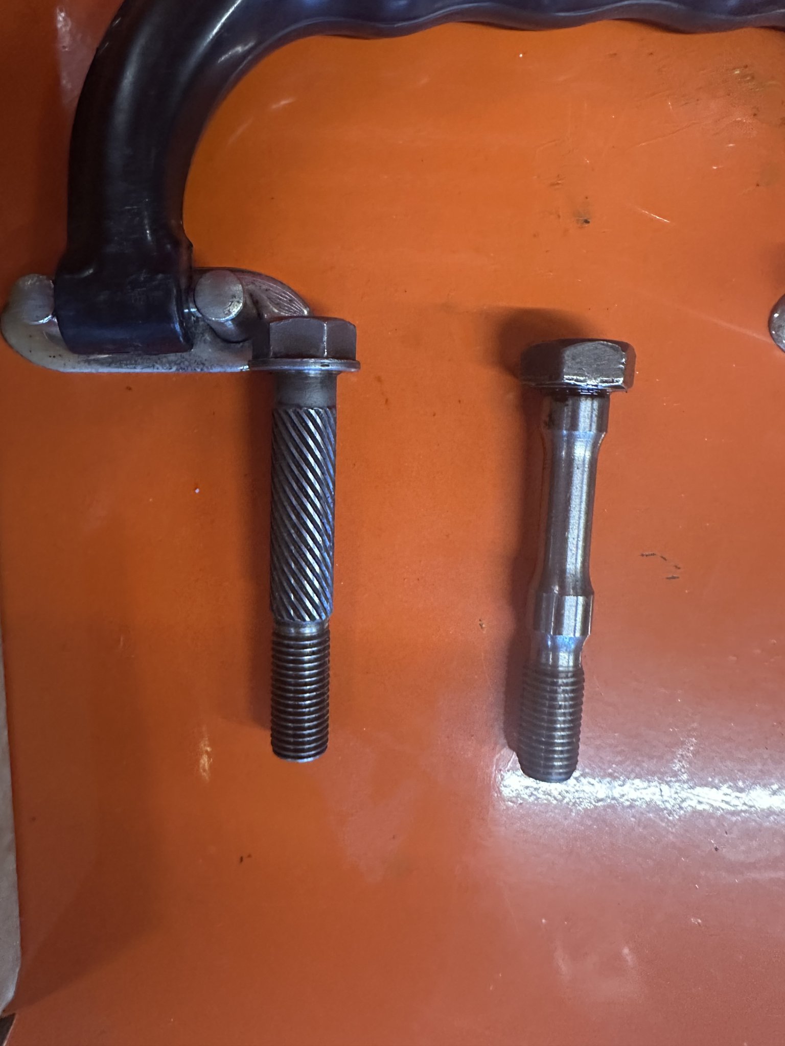

So replacement rod bolts are completely different designs. The new ones on left fit the old rods, but are they going to work out ok?
New replacement rod looks the same but is way heavier (19 grams) on big end and way lighter (10 grams) on small end. I can fix the big end and I think she’ll be ok with the small end since it won’t be turning 7 grand.

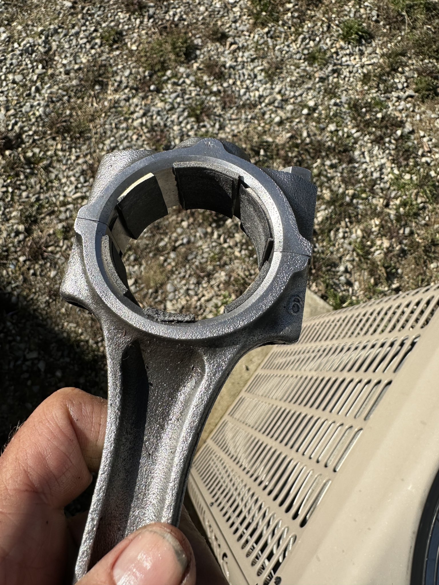

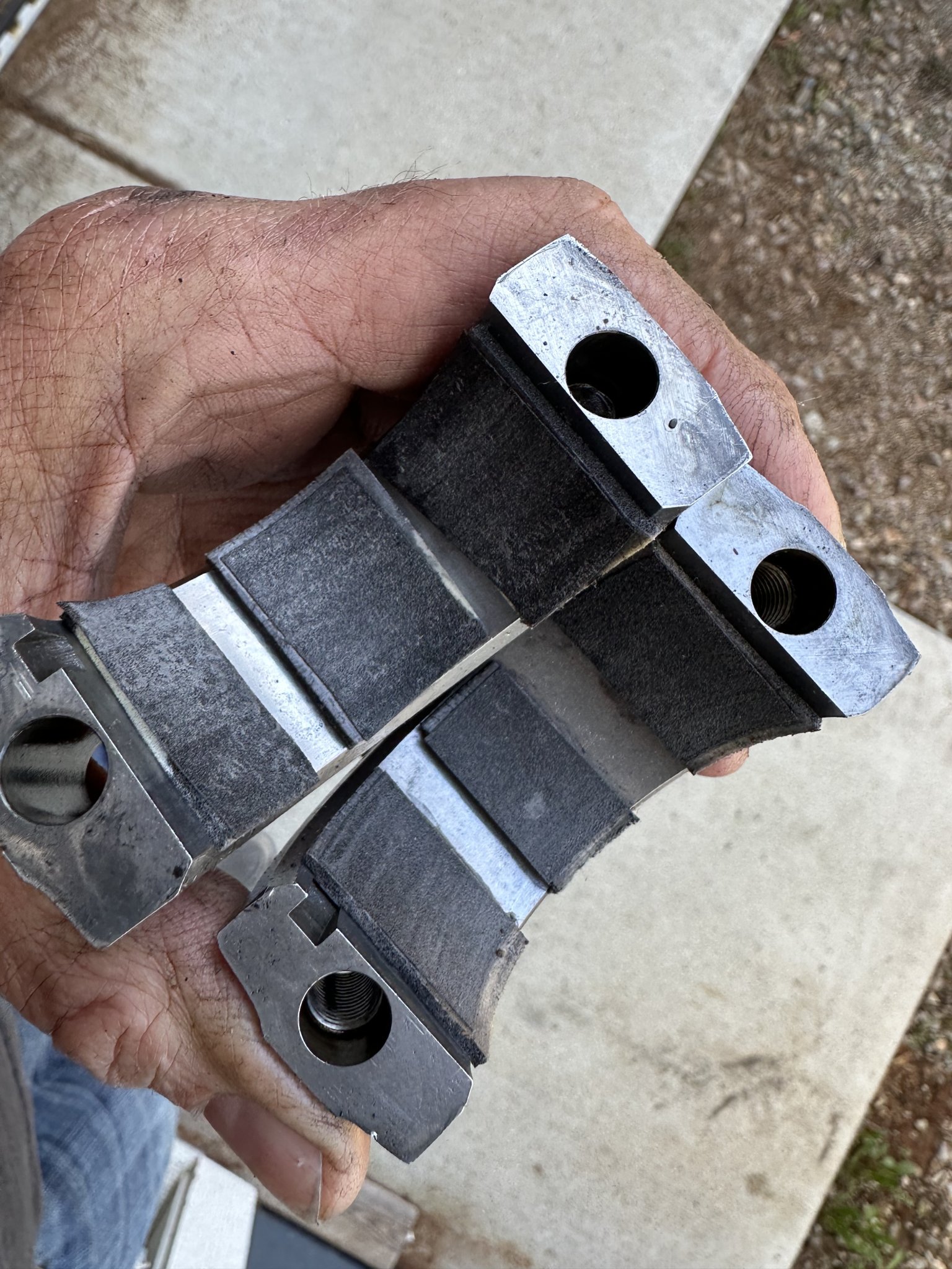

Also, after waiting 3 weeks, the Chi-Com Yannal brand rod bearings don’t fit (OD is way too small and too narrow) Box says v-1702:mad:. Are they maybe for an IDI engine? Re-Ordered from a US vendor and put in for a return. We’ll see if these work. 1 step forward, 2 steps back!

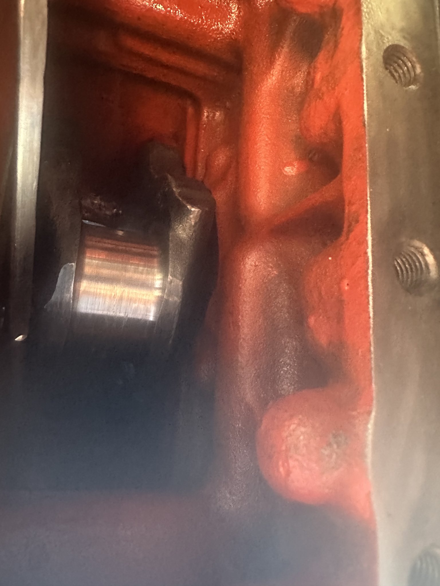

So I gave the rod journals another pass with my “connecting rod journal polisher”. Hit number one with 250 “swings” of 320 grit, followed with 250 swings of 400. Then I hit the other 3 with 200 swings of 400. Looks pretty decent, my #1 final bearing clearance was .0035”, .0001” over spec for new and about half of the wear limit. The other journals are at .002”, right in the middle of spec. Thankful for those flame hardened journals!
I decided to get a used original rod with new bolts for #1 to get a better weight match. The rod/piston assemblies are ready to go. The complete piston/ rod assemblies weigh in at 1487,1488,1488,1489 grams now. Pretty close.
I bought Riken brand rings from Taiwan and I’m impressed with the quality, cost a bit more ($140 a set vs $35) but I’m thinking they were best value. Close copy’s of originals and moly faced top ring, consistent sizing. All gaps within .001 of each other. She’s going back together soon.
#1 rod journal :

i would recommend removing the injectors from the head before doing any more work on it. You should have removed them before cleaning but it's a but late for that. Injector nozzle should not be cleaned with a wire brush, a hard or abrasive tool.
The journal does not look too bad but will need cleaning and I would recommend turning the crank so the oil hole faces down and flush it out with brake clean. by micing the journal you should have a pretty good idea of the clearance you will end up with.

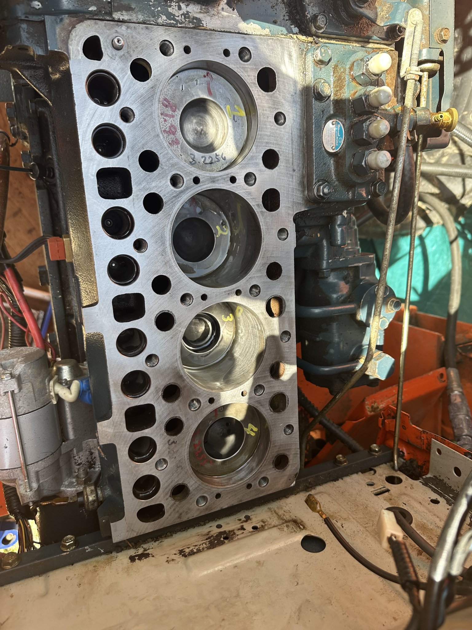

So got engine back together last night and fired her up Runs great and no leaks, and no smoke! Thanks all, and especially Wolfman, I couldn’t have done it without everyone’s help. I’m new to these machines and there’s lots of nuances to working with them.
I ran a quick compression test before I put the Intake manifold on and I got:
#1: 360
#2: 370
#3: 380
#4: 380
Huge improvement. This is stone cold with no break-in of the rings whatsoever. Motor sounds good, most of the noises seem to be from the injectors ticking.
Head got new exhaust valves, touched up exhaust seats with my Black and Decker seat grinder, lapped the intakes, and installed new valve seals. Guides were all good. I also ran some 320 glued to my granite surface plate over the deck and head. I used an OEM head gasket, the rest of gaskets are from the cheapest kit I could find.
One tip I can pass on is that , before putting head back on, pull each lifter out. ( one at a time) flush it out with brake-cleaner spray, oil the body and lifter bottom, and reinstall. I flushed out bits of old head gasket material in every one of them when I did this.
Now to get the front axle and driveshaft back on, then it’s back to work! Hafta poke 20 or so holes in the ground for my new pole barn next week!
