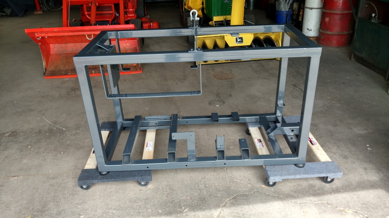

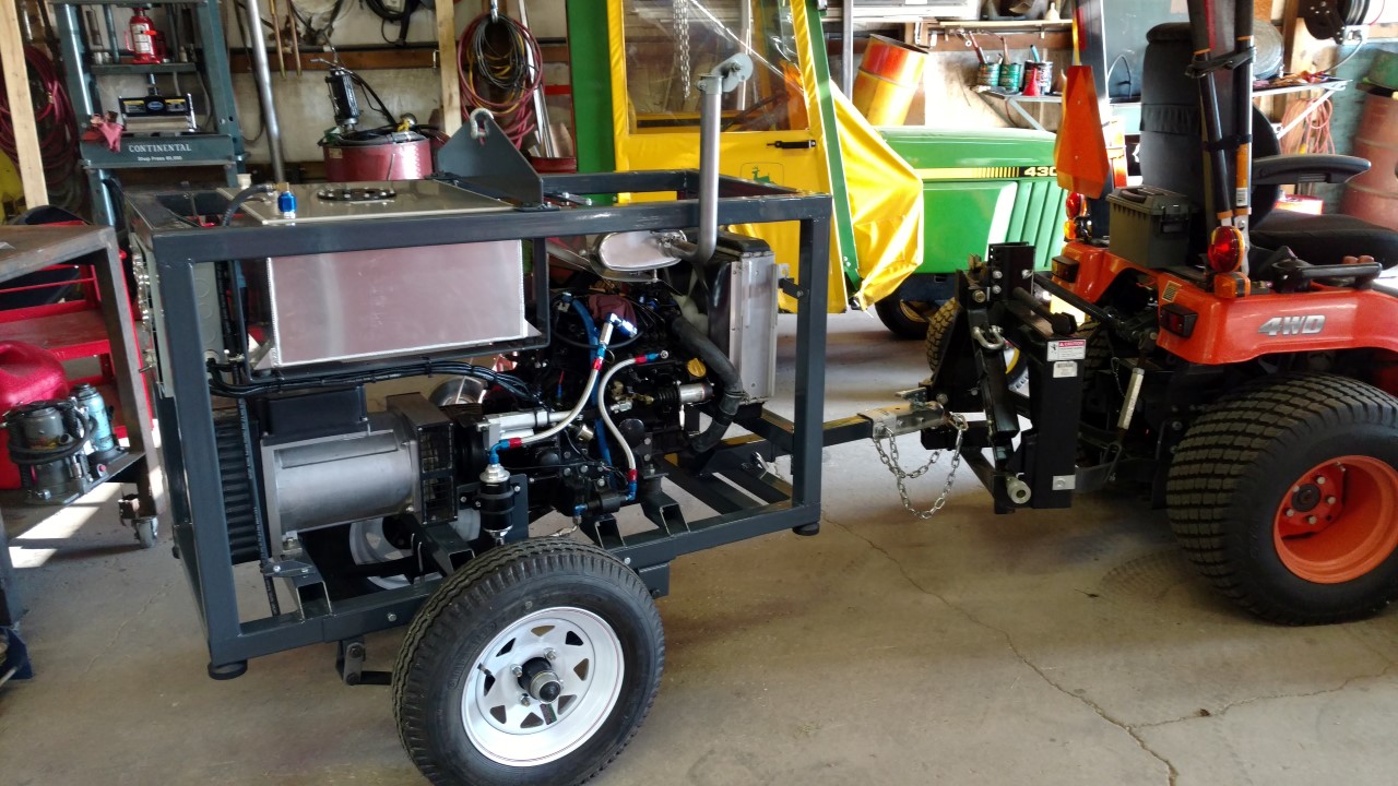

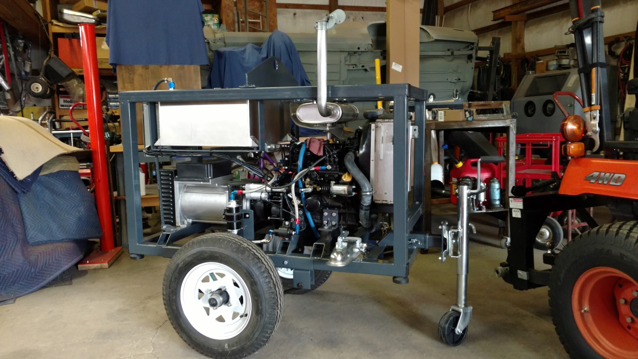

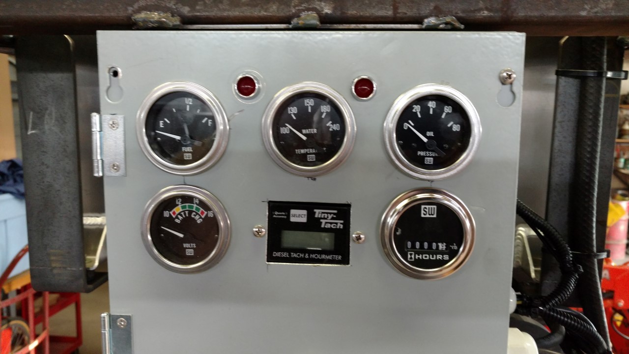

I started building it over 20 years ago and the project got derailed and sat on a bench since then.
The engine is a Yanmar 3TNA-72UJ 22 hp unit that I bought from a JD lawn and garden dealer. I was a take engine out of a compact tractor that had an intake/air cleaner failure, and the owner demanded a new engine to replace it. I saw it there one day and asked about it, and ended up buying it for $500. Took it to the shop and disassembled it. It only had ~40 hours on it and was nearly pristeen inside with a few very light scratches on the cylinder walls. Gave them a light hone, put new rings in, new bearings and gaskets, and put it together. I bought a new 10KW generator from then Northern Hydraulics, built a cage from 2" X 2" 11 ga tubing and got the engine and generator mounted up and coupled together. First time I started it the coupling disintegrated and bent the shaft on the generator. And that's where it sat for 20 years.
A couple of years ago when I retired I decided to get it finished up, so I disassembled the generator and was able to get the shaft straightened to within .001". Looked around for a different type of coupling and found on at McMaster-Carr that with tolerate a fair amount of misalignment. It kinda looks like a rubber tire with a drive plate clamped to each bead. I bought a 14 gallon fuel cell from Summit Racing, took out the anti-slosh foam and made brackets to mount it over the generator. Made an exhaust system out of 1.5" stainless prebent pieces and used a muffler for a Honda of some sort. The intake system is just some radiator hoses and the airfilter is for a BX like mine, with a motorcycle conical airfiler on the inlet to help wuiet the intake drone. The radiator was also a JD takeout that had the top tank damaged, but I was able to fix it with JB Weld. The fan shroud was made from scratch of fiberglass by a friend. Engine mounts are also off a JD compact tractor of some sort. An electric fuel pump feeds a billet fuel filter and I used a stock JD fuel shut off solenoid. I made an throttle actuator out of a linear actuator and some fabricated to allow the actuator's travel of 2" and the throttle travel of just an inch. I built a control box and installed gauges, a digital tach, ignition switch, idle run switch and fuses, and wired it all up to the engine. I also mounted a battery maintainer to keep the battery up to snuff.
It works great, just turn the ignition on wait until the glow plg light goes out and crank it up. Let it idle and warm up a little and flip the idle/run switch to run and it runs up to governed speed.
I also built a subframe with an axle and a removable hitch so it can be towed if necessary.
Still need to find something to use for side covers with some sound absorbing material, but for ow it will do what I need it to do.
