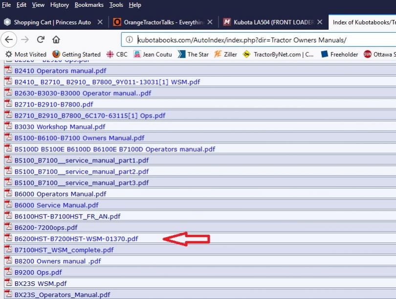

Start by downloading a free Workshop Manual here:
http://kubotabooks.com/AutoIndex/index.php?dir=Tractor Owners Manuals/
Dave
