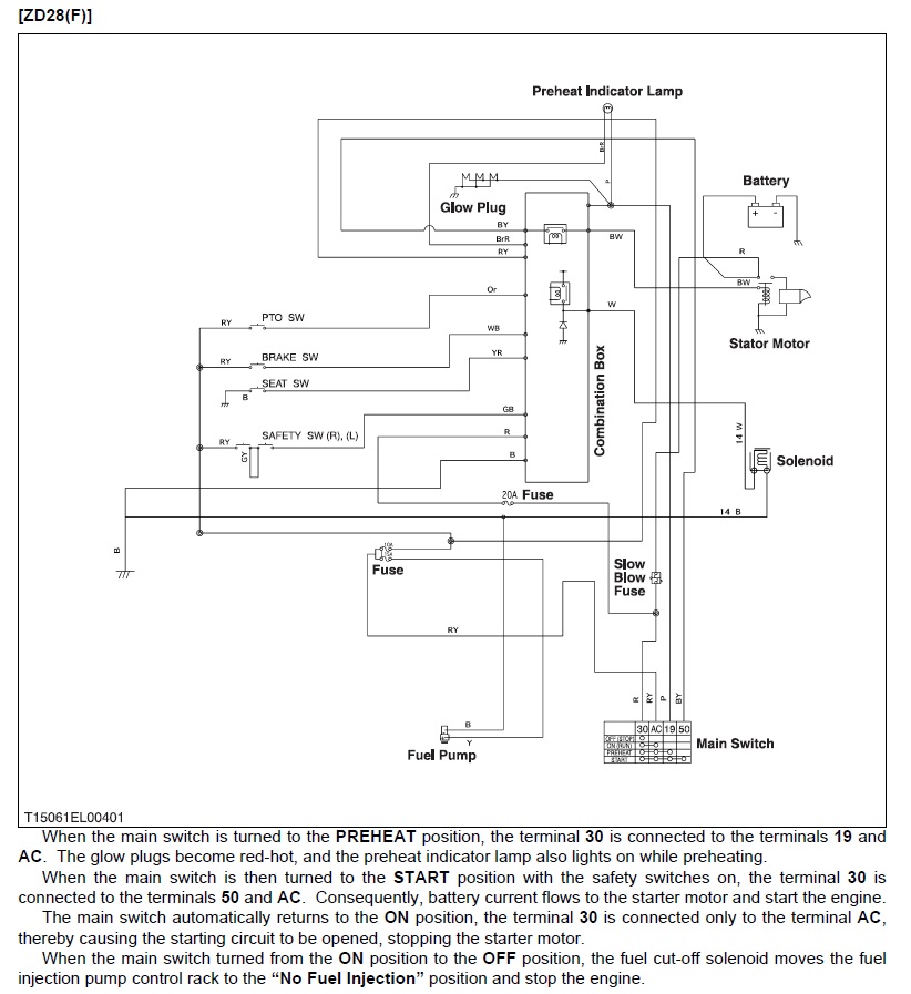

Did you download the WSM at KubotaBooks? Assuming the schematic accurately describes your mower, there should be a spring-loaded position between accessory and start that turns on the glow plugs and the light. The light is grounded through the 'combination box' (is this what you're calling the controller?), and I assume that box opens the ground after a certain time, turning off the light. But even if the box fails, the glow plugs heat because they're wired directly to the switch. The plugs should get power in the pre-heat and start positions. Unlike some tractors, your plugs get full battery voltage.

I am not clear what item you are referring to when you say 'new controller."
The key device is called a combination box.
Provide the part number and that will clear up what you are referring to.
The plugs are wired in parallel to answer 85Hokie's question.
The terminal numbers referred to in the operating description are shown in the logic box beside the MAIN SWITCH in the lower right corner of the wiring diagram.
The"pre heat indicator lamp," is controller by the combination box which is why it is important we clarify which items you replaced.

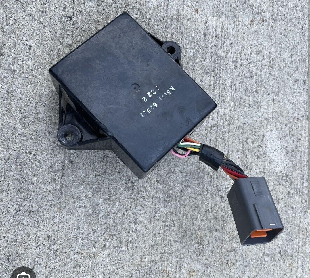

This is what I'm calling the controller
Prior to replacing this device I was getting no voltage to the glow plugs when the combination was in the preheat position.
I had to turn the machine of manually at the shut off solenoid before this replacement too.
