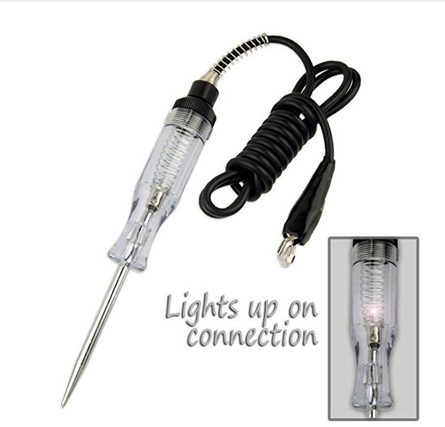

1. Use a test light to check for power to each GP. Also check the GP's are powered while the engine is cranking.

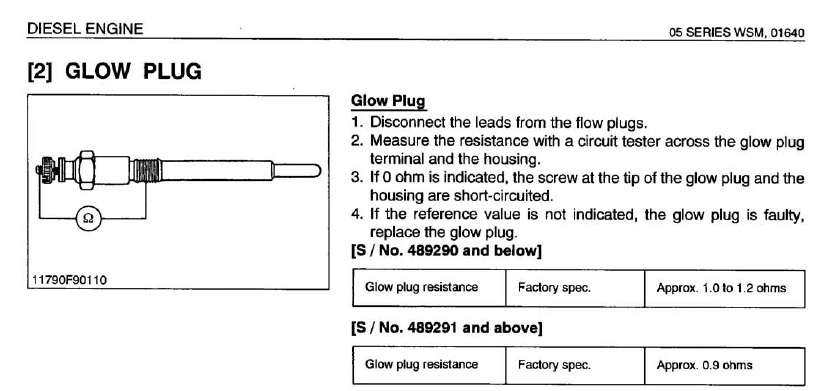

2. A cheap multi meter. Remove the wire on each GP and measure its resistance from the electrical terminal to ground. Should be 0.9 ohms.

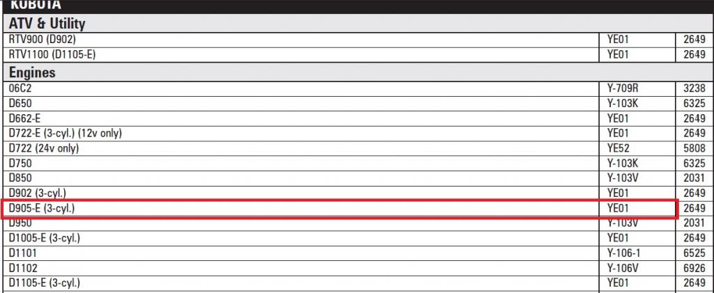

An NGK catalogue shows YE01 for D905 engine

If you are not aware of how to check each glow plug, you have to disconnect each glow plug from its circuit. That is so you can isolate each plug from the others. If you have an OHM meter, check them with that and look for 1.5 to 3 ohms resistance.
