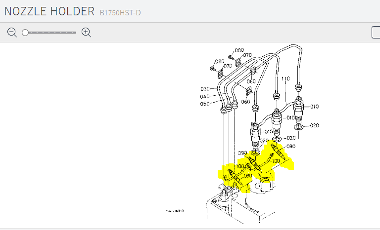

North Idaho Wolfman Moderator Staff member Lifetime Member Equipment L3450DT-GST, Woods FEL, B7100 HSD, FEL, 60" SB, 743 Bobcat with V2203, and more Jun 9, 2013 33,936 9,150 113 Sandpoint, ID Apr 4, 2024 #2 charles j said: How many glow plugs does this three cyl have? I only found one and there is no current going to it. Anyone know where the fuses are? Click to expand... You have three, I have a sneaking suspicion your not looking at a glow plug. There is no fuse for the glow plugs. The glow plugs are in the side of the head, just above the intake.

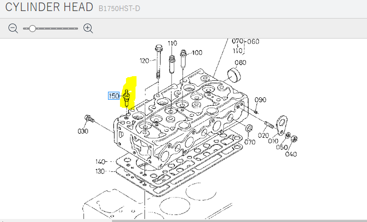

C charles j New member Equipment B1750 Apr 4, 2024 2 0 1 Portland Apr 4, 2024 #3 North Idaho Wolfman said: You have three, I have a sneaking suspicion your not looking at a glow plug. There is no fuse for the glow plugs. The glow plugs are in the side of the head, just above the intake. View attachment 125668 Click to expand... There is something that looks like a glow plug on top of the head. Do you know what that is?
North Idaho Wolfman Moderator Staff member Lifetime Member Equipment L3450DT-GST, Woods FEL, B7100 HSD, FEL, 60" SB, 743 Bobcat with V2203, and more Jun 9, 2013 33,936 9,150 113 Sandpoint, ID Apr 4, 2024 #4 charles j said: There is something that looks like a glow plug on top of the head. Do you know what that is? Click to expand... That would be the temp sending unit: No voltage to it, and it senses heat, not makes it. Reactions: 1 user
