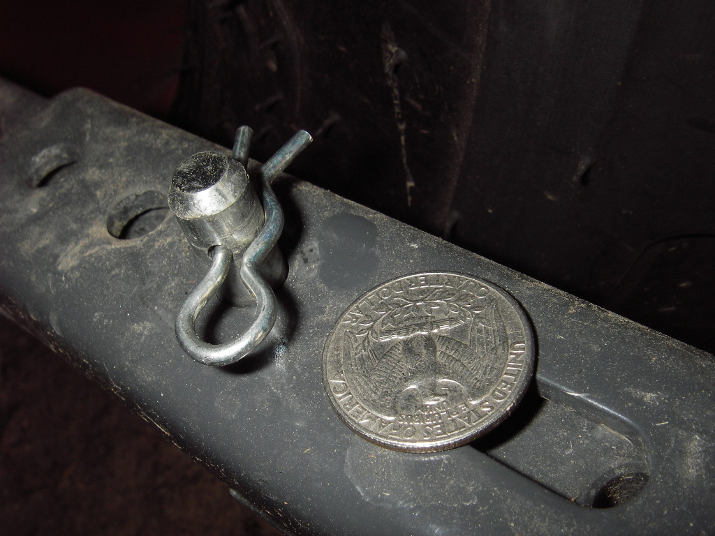

Sometimes there isn't enough room for a decent size lynchpin so they use 'R' clips. The bigger ones that your finger fits in are Ok but the tiny ones are a bear to get in and out sometimes.

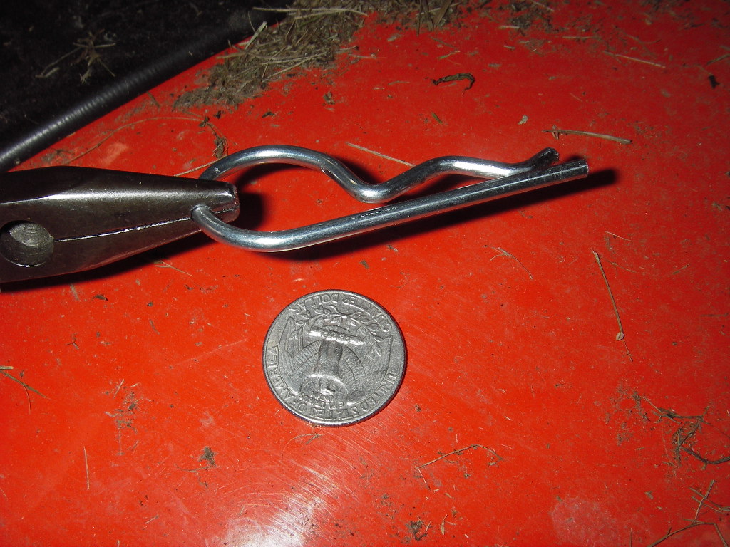

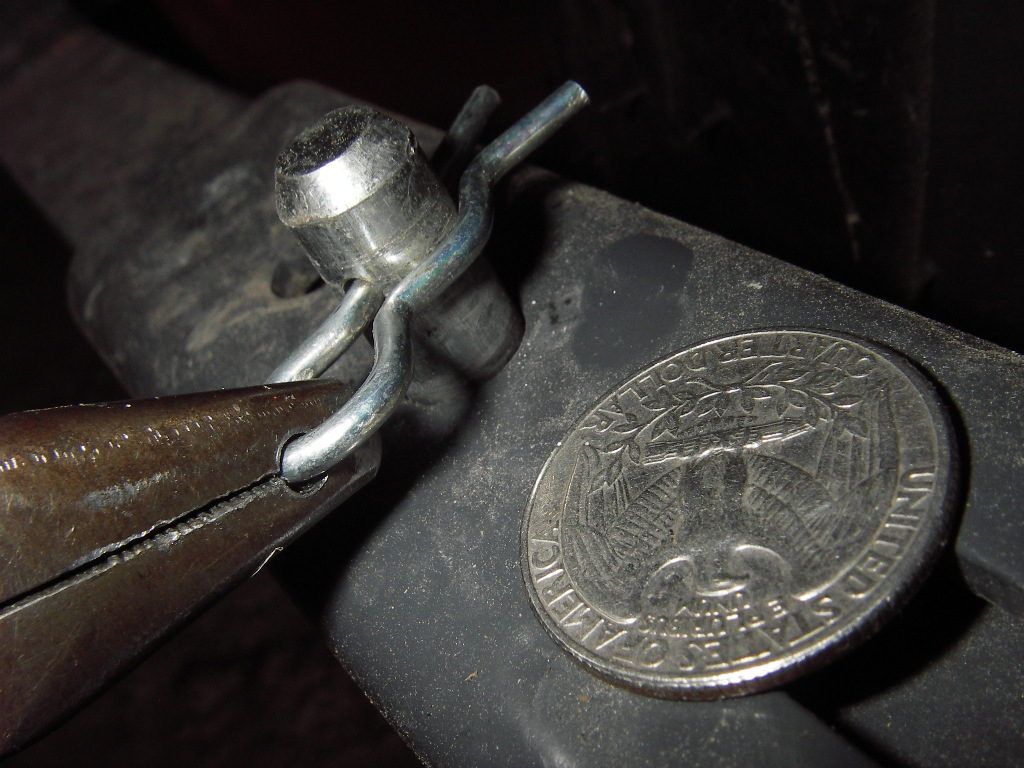

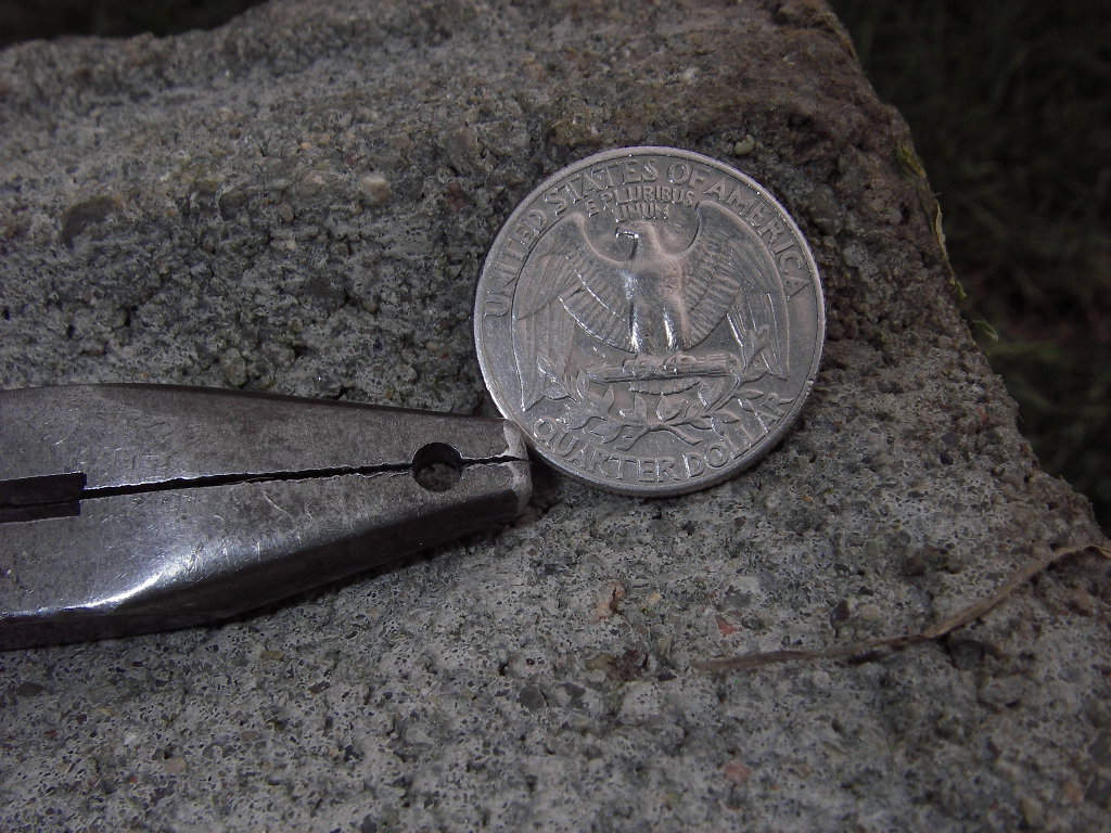

I modified an old pair of pliers by drilling a hole near the end and they work so well I'm posting it.
Tiny 'R' clip
Hole in pliers
Gripped
Fits larger ones too

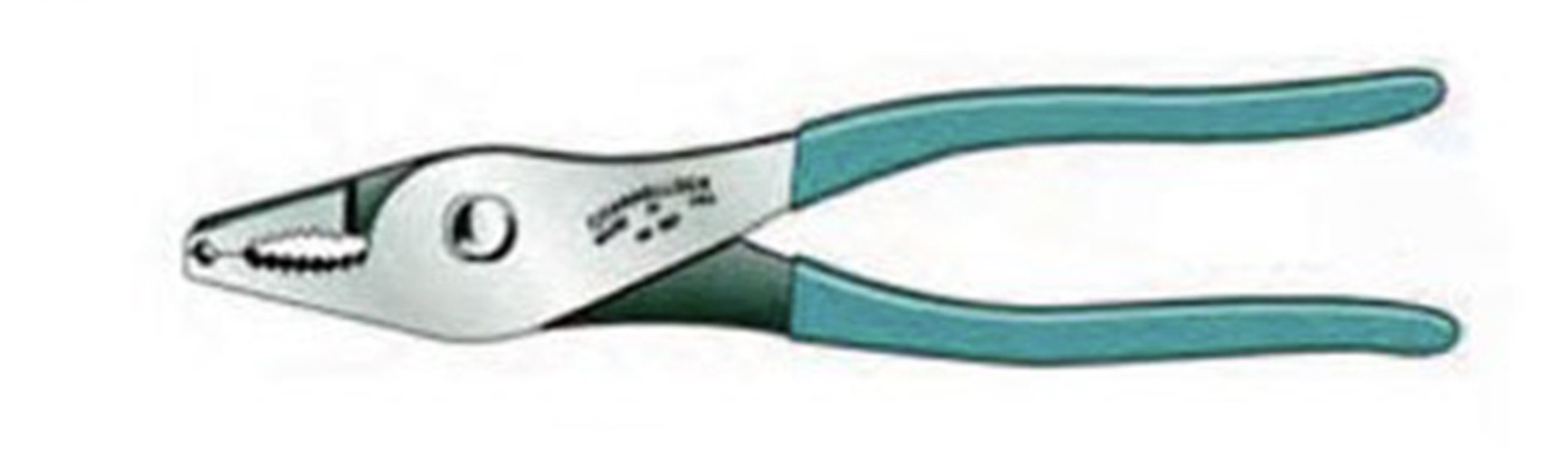

I like it, but I'm a tool guy.
I'll look around for a spare pair of needle nose to mod & throw in the onboard tool kit.
Don't have any baler twine, but but I guess any string/wire would work.
Oh wait, I have a couple pairs of these laying around. :)
